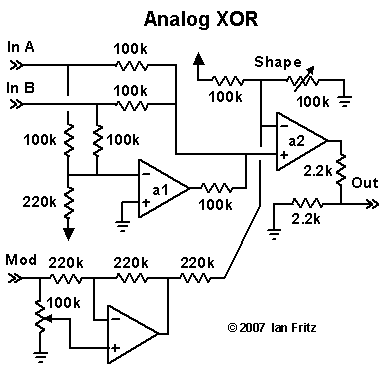

A while back I built an XOR circuit ("digital ring modulator") to use with my various pulse waveform generators and shapers. Rather than using a digital IC I used an opamp design that I found in an old EN App Note. It worked just fine.
But then I got curious about what would happen if I fed it continuous (non-pulse) waveforms. After some head-scratching and calculations I figured out that what the circuit does is to go high whenever the sum of the two inputs is between -5V and +5V. And it does indeed produce some interesting ring-modulator type sounds.
To increase the circuit's versatility, I put in a pot that allows the lower threshold to be varied from the negative supply up to the upper threshold. So the output goes high when the sum of the signals is between x and 5V, where x is between -12 and 5V. I've just started to play with this, but it seems pretty cool.
Here are the schematic and a very short mp3 clip. For the clip, two TRI waves were sent into the unit via VCAs. The VCAs were run by envelopes from the AD/AR I mentioned in another thread. One AD is delayed from the other, which is set for a monostable-driven AHD envelope.
Enjoy!
Ian
NB: Edited to add modulation to schematic.

This looks very interesting Ian. I would like to try it out this weekend. Is there however a recommended op-amp that you would use? I have lots of old 741's I'd like to find a home for, would these be okay?
Would different op-amps lead to differing thresholds re. -5v to +5v?
thanks, usine.

Hi Usine --
There's nothing at all critical about this circuit and anything you throw together should give interesting results.
I used a TL072 opamp. A 741 will show some slew-rate limiting (the pulse edges will be sloped) but I wouldn't worry about that unless you need very high frequencies or very clean pulses.
The threshold levels I stated are approximate and based on 12 V supplies. If you use 15 V supplies you might want to increase the 220k resistor to something 270k or 330k.
Thanks for your interest Exclamation Please let us all know how this works out for you.

Ian, if the shape control could be replaced by a vactrol arrangement providing a similar voltage range, (probably not easy!) which is driven by an envelope follower control voltage derived from a guitar connected to one input, and say the output from a PLL (4046 perhaps) connected to the other, also driven by the guitar, we might have some interesting results. What do you think - on my desk 9am Monday morning!! Wink

Per requests I added a modulation section to the schematic. It's not obvious what the best way to do this is, but the one drawn works pretty well. I used a "switch hitter" so the sign of the modulation can be changed (zero modulation when pot is centered). The schematic in the original post has been updated.

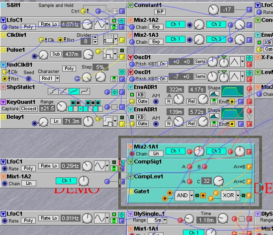

v-un-v
Joined: May 16, 2005
Posts: 8932
PostPosted: Sat Nov 17, 2007 9:52 am    Post subject: Reply with quote  Mark this post and the followings unread
hey Ian! that's an interesting looking circuit Very Happy
Thanks for posting it!
ACHTUNG!
Posts: 24420
Audio files: 297
PostPosted: Sat Nov 17, 2007 10:30 am    Post subject: Reply with quote  Mark this post and the followings unread
frijitz wrote:
How involved was it to get the function put in?
Not very Very Happy
The blueish modules implement it with the modulation being done as well.
The rest of the circuit is part of the noodle I built around it. This one does not have the portamento mentioned.

PostPosted: Sat Nov 17, 2007 6:12 pm    Post subject: Reply with quote  Mark this post and the followings unread
Thanks Jan!
I don't understand the G2 well enough to figure out what you have set up. I would have expected two comparators to pick out signals (In1+In2) above and below certain limits then an AND gate to ensure both conditions are met. What you have done is equivalent to this?
Ian

Posts: 24420
Audio files: 297
PostPosted: Sat Nov 17, 2007 7:18 pm    Post subject: Reply with quote  Mark this post and the followings unread
Your description was that the output should be one when the sum signal would be < 5V or > 5v and zero otherwise, and I tried to do just that.
I assumed 10 V would be the max signal level and mapped 10 V onto 64 "Clavia control units" (the max, well, the unit units count really, there is some headroom above that). And so I had to map 5 V to 32 units.
I have two >= comparators, one set to a fixed value of 32 and another that can be controlled by input units (voltage equivalent), modeling the modulation on the lower value (it can go too high here with improperly set control voltages/units).
The xor on the outputs of the comparators will give the windowing function like you described it ... I hope the following table will prove that Very Happy
Code:
  >= -32 (or variable) | >= 32 | xor
          0            |   0   |  0
          0            |   1   |  can't occur
          1            |   0   |  1
          1            |   1   |  0
