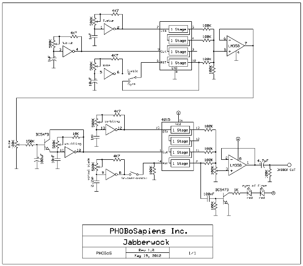

speaking of random,. I was thinking of hooking up a shiftregister with some EXOR's as one of those
semi-random generators, with resistors attached to various points. Not sure how it would sound at audio
rates, I expect noise, but it would probably make an interesting LFO (or is that what Buchla did ?!)
Anyway here's an offspring.
I had noticed when playing around with it I could get voice like sounds but I got the best effects when
turning a pot so I wanted some modulation. Digging through the forum I found a way to turn a 40106 into
a VCO and with a little bit of tinkering this worked as I wanted. At first I thought I patched up some
feedback loop causing chaotic behaviour, but after drawing the schematic this doesn't seem to be the case,
It still sounds pretty chaotic though, so I am wondering if there might be some feedback through the
powerlines but I'll find that out once I soldered it up. (hope it will still work)
Here's the schematic and 10 minutes of non-stop jabbering without me touching any pots.
(in Gyre mode and without Snicker-Snack!)
Beware the Jabberwock!
 Filesize:  64.43 KB
 Viewed:  1307 Time(s)
PHOBoS - Jabberwock Demo (May 18, 2012).mp3
10 minutes of non-stop jabbering without any knob twisting.
 Filename:  PHOBoS - Jabberwock Demo (May 18, 2012).mp3
 Filesize:  9.14 MB
 Downloaded:  2004 Time(s)
PostPosted: Sat May 19, 2012 6:24 am    Post subject: Reply with quote  Mark this post and the followings unread
Beautiful! sunny
I especially love the "eyes of flame" Shocked Laughing

PostPosted: Sat May 19, 2012 8:14 am    Post subject: Reply with quote  Mark this post and the followings unread
Wow! Awesome and creepy. A talking lunetta Surprised

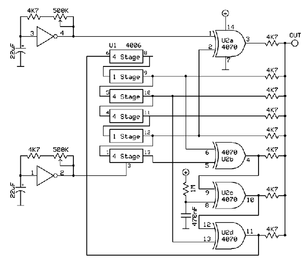

PostPosted: Sat May 19, 2012 1:56 pm    Post subject: Reply with quote  Mark this post and the followings unread
Can you maybe post a demo of this circuit going thorough different waveforms? Like saw, ramp, sine etc... The E.P.'s are nice but I'm having trouble hearing what this does. Confused
Posts: 5881
PostPosted: Sat May 19, 2012 4:31 pm    Post subject: Reply with quote  Mark this post and the followings unread
depends which one you mean:
- the original 4006 based circuit by Cyno, with the switches for stepped
triangle/sine/spiked outputs.
- the 4015 triangle and saw generator (with nice simulations by nardu)
- the Jabberwock
the last one doesn't really do triangle, saw or sine, it just a mess what
comes out of it. But it is some sort of stepped waveform.
And good news, I just soldered it up and it's jabbering like a wocky.
it does seem to sound a bit more digital with more bleeps and blips
(I can get some nice random glitching out of it), but it works Razz

PostPosted: Sun May 20, 2012 4:44 am    Post subject: Reply with quote  Mark this post and the followings unread
PHantastic, PHOBoS! The beamish Jabberwock machine, I mean. Well, all of what you posted. Voice-like sounds are always fascinating. I definitely want to breadboard the Jabberwock, if only to see the "eyes of flame"!
What about running the output of that into one of the other waveshapers? But I guess feeding a stepped waveform into that wouldn't yield a triangle, but rather more uffish waves.
Just to clarify, both the 4006-based and the 4015-based waveshaper circuits produce a lower frequency triangle (/sine/saw/ramp) wave than the input square wave, right? So these are actually waveshaper-dividers. I was not entirely successful in using these with the [JovianPyx] 4046 frequency multiplier circuit [ http://electro-music.com/forum/topic-53504.html ] yet, but I have not had a lot of time to work on this lately.
James.
Posts: 5881
PostPosted: Sun May 20, 2012 5:44 am    Post subject: Reply with quote  Mark this post and the followings unread
dwarf I'd love to hear your experience with it, it works for me but it's always nice to have someone else test it.
I was thinking of maybe adding a LED to the vorpal blade aswell. One two! One two!
That wouldn't be very usefull since the output is an analog waveform or at least has more than 1 voltage.
You could use a comparator or remove 2 of the resistors of the 2nd shiftregister, but I think that
would just result in a galumphing pulsewave. If you feed that into the waveshaper you would get
a varying stepped triangle/saw waveform. Kinda like the LFO test I did but with a more random pattern,
but for that I was thinking a 4006/XOR setup with a couple of resistors.
You can also use bigger shiftregisters, but not sure how that would change the sound,. it might make it more slithy.
yes, that's correct. And its one óf the reasons why I like to use the 4015 over the 4006,. because
it has 1-stage shiftregisters you can use a lower input frequency than you need with the 4006, to get
the same output frequency (it still will be a division off course).

anyway, I finished the Jabberwock Very Happy except for the knobs which I ordered (should arrive tomorrow or the day
after) so I'll post some pics when I get those. I think it turned out pretty nice. So after I finished
that I decided to do a quick experiment with the 4006/4070 semi-random generator idea. Below is a schematic
of the test circuit I used and a demo. As with the previous LFO test I used the ouput to control a VCO. It sounds
as I expected and i think it's very usefull Smile (I also did a quick test how it sounds at audiorates but as I allready
thought it's noise, however you can control the sound with the CLK speed)
I first breadboarded the random generator and then added the spare XOR fed with an extra oscillator and
a randomly chosen output of the 4006. So far I've only seen 4 outputs of this random generator setup used
in circuits so i guess those are the random bits. By adding more resistors I actually combined it with the original
waveshaper circuit, and as an LFO this creates some nice arpeggios.
When I drew the schematic the first thing I noticed is that pin 8 is unused so i could attach the spare XOR
to that instead of an extra oscillator. This way you could turn it into a nice 2 chip module with just a an input
and output.
however adding some extra oscillators = more fun, but I did notice that because it's not in sync with the CLK
it doesn't actually sound that nice all the time, depending on the sounds you want. One idea is to add
a flipflop triggered by the CLK after the oscillator. Or throw in a 4040 aswell, and have it triggered
at a different speed but still in sync. Another idea is to add Psyingo's swing generator.
One thing I'm certainly gonna add is a rotary switch to choose between some different configurations.
As it's drawn now there are no resistors added to either pin 8 or 13 of the 4006. Instead of just adding them
I think it's nicer to choose between different setups. This should give some slightly different sounding
sequences. I might be able to wire it up so you can get a stepped triangle and maybe even a saw out of it
aswell since the basic circuit for that is allready present.
let's see what's more, ah yeah, I used a third oscillator attached with a 100 ohm resistor and pot in series to
the resistor network. This creates a nice vibrato effect. I have to do some more tests to see what pot value gives
the best range. (I used 100K). And as in Cynosure's original circuit I also added a cap to ground. Because it's used as
an LFO I added a 100uF, this creates a glide effect. It should work with a pot in series, and you can use a smaller
cap when there's a buffer opamp. But I've run out of LM358's (ordered with the knobs) so once I get those I'll
do some tests with that.
and a last thing just for fun,. add a 7-segment LED display to all the outputs you wire the resistors to. Very Happy
edit: just noticed that right now U2c is just an inverted version of U2b which means they cancel each other out.
 Filesize:  39.79 KB
 Viewed:  707 Time(s)

I just posted some pics of the Jabberwock here Cool
I added a LED for the Vorpal blade, and switched the terms 'Vorpal blade' and 'Snicker-Snack!' around.
Makes more sense this way Wink I also switched the resistors and pots of the oscillators around to make it
easier to wire up. I might post an updated schematic with those changes and the pin numbers for the 40106
as i used them on the PCB. (mainly usefull for myself to look up).
