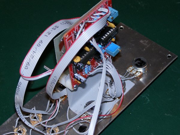

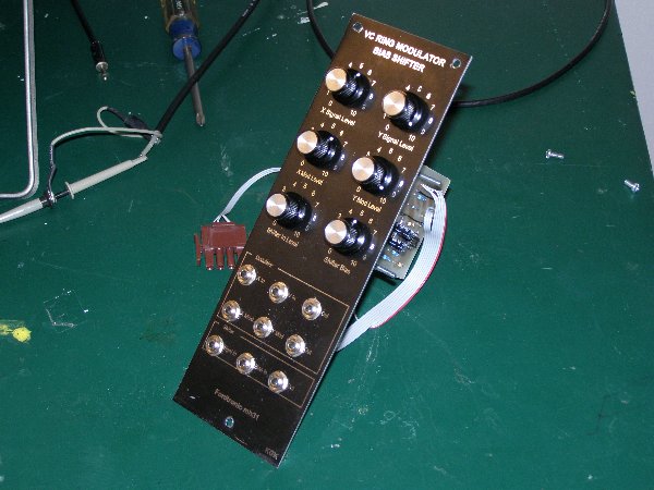

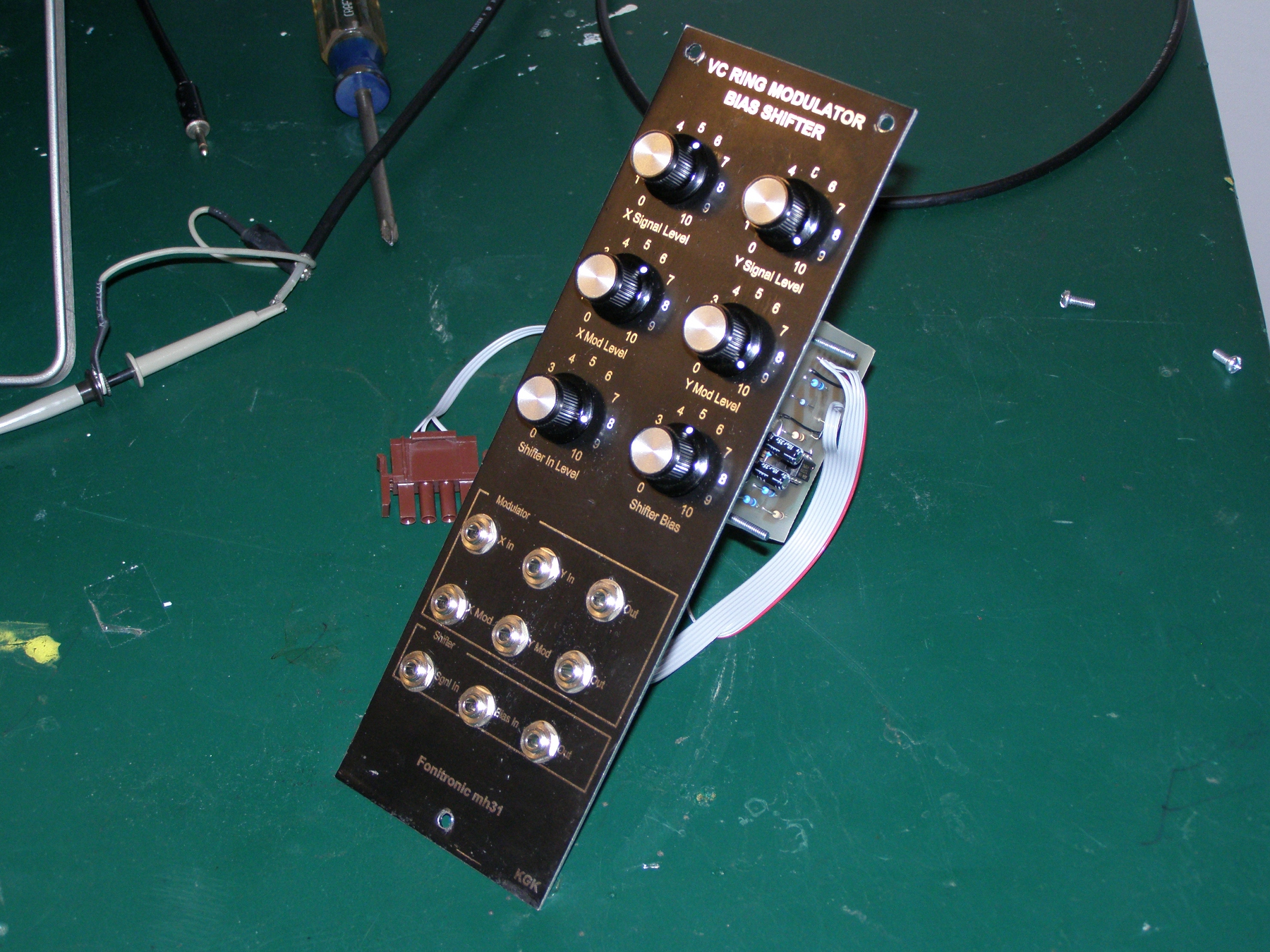

I just recorded a demo and a short improv with this module.
One adjusts the signal levels (the carrier and modulator -- X and Y) to null out the primary input signals.
Since the Voltage control varies the X and Y levels, external voltage can control the nulling effect ("bleed through") and effect some amplitude modulation, too.
I labeled the inputs X and Y to match the Aries labeling (used for the Aries Balanced Modulator).

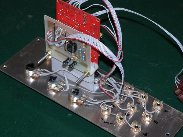

The VC Ring Mod didn't utilize all of the Aries 9x3 panel, so I added a separate Gain/Bias function to the module.
 Filesize:  1.29 MB
 Viewed:  540 Time(s)
This view shows the VC Ring Mod PCB
 Filesize:  1.6 MB
 Viewed:  496 Time(s)
This view shows the Gain/Level Shifter PCB.
