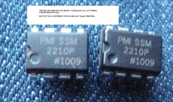

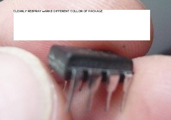

GUYS DO NOT BUY ANY PARTS FROM utsource
I did buy plenty of ssm 2210s for this vco from them .none work they are all FAKE.

have you contacted them about it? i mean, do they refuse to refund you?

I got 50 2210s from utsource a year or so ago and they're fine (so far!).

Am buzzy,i wait on reply,atm they don't believe they are fake.

i believe it was in the Jürgen Haible section, i read about fake MN3005 from utsource, which they refunded in the end (i haven't looked it up again in detail now)
let's hope you get that sorted.

I did send back the 50 ic's,they refunded the total costs incl. the shipping Smile
