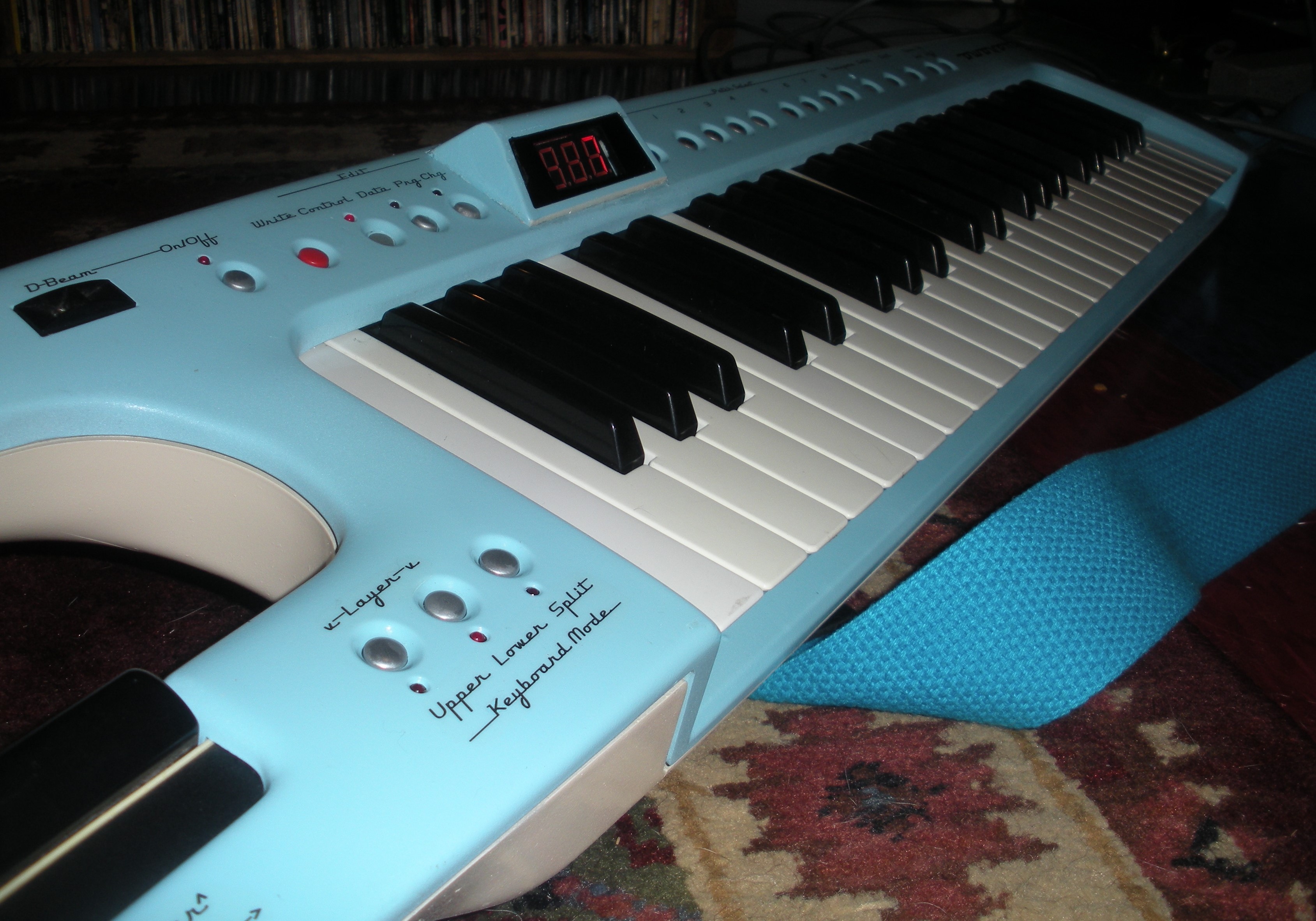

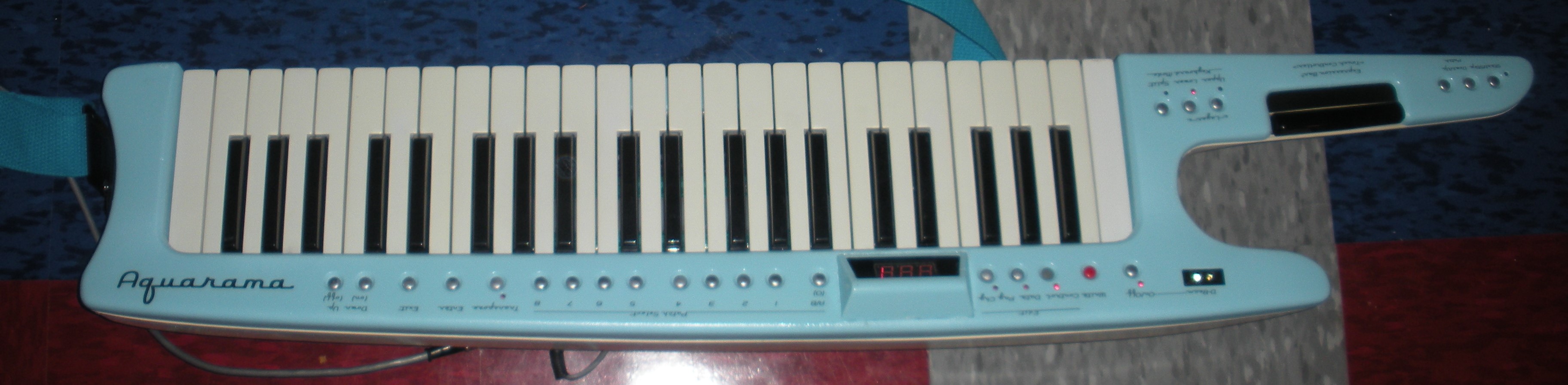

PostPosted: Fri Jun 12, 2015 3:16 pm    Post subject: Roland AX-7 restoration Reply with quote  Mark this post and the followings unread
I just finished restoring a Roland AX-7 I got for cheap off ebay this winter. It was cheap because the body was duct-taped together, the previous owner actually abused it to the point of the internal standoffs breaking off. Hmmm imagine a rock performer abusing a piece of musical equipment! Wink
Anyway, I took the opportunity to get rid of the boring all white finish that came with the factory model.

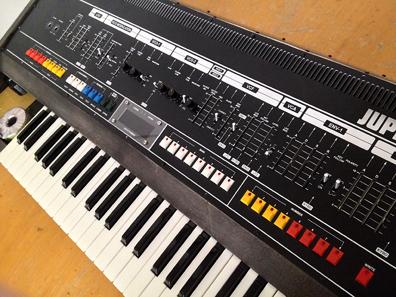

PostPosted: Sat Jun 13, 2015 4:10 am    Post subject: Jupiter Clone
Subject description: 4 Voice Jupiter clone
Here's something I've been working on at these last couple months.
It's a four voice JP clone build using original Jupiter 8 schematics.
Each four voices have two VCO's per voice as in original.
Modules build so far are :
8 x VCO cards each with Saw, Square and PWM waveforms.
Each sound card has 4052 multiplexer as on output controller as in original so each voices waveform can be assigned digitally.
4 x 4-Pole "Roland" OTA Filters. Made pretty much same way as 80017A filter clones.
2 x VCADSR cards that control ENV1 and ENV2 envelope generators.
+ LFO card, PWM control section and various Modulation Control "cards" that control and mixes various modulations to each filter and voices.
Here is couple videos from the clone so far :
https://www.youtube.com/watch?v=1fX8TPMrIbY
https://www.youtube.com/watch?v=x9K_TSB4fHM

AMAZING Shocked

kanji - Wow that is nice! You made the case as well?

Thank you for the comments.
I did the casing and panel as well. Casing is not 100% ready yet.
I still need small panel for pitch bend/modulation control section and this synth is going to get aluminum ends, like the ones in real jupiter 6/8 Smile

Spiffy restoration, Dan. Love the color, and especially the labeling.

Looks incredible so far!

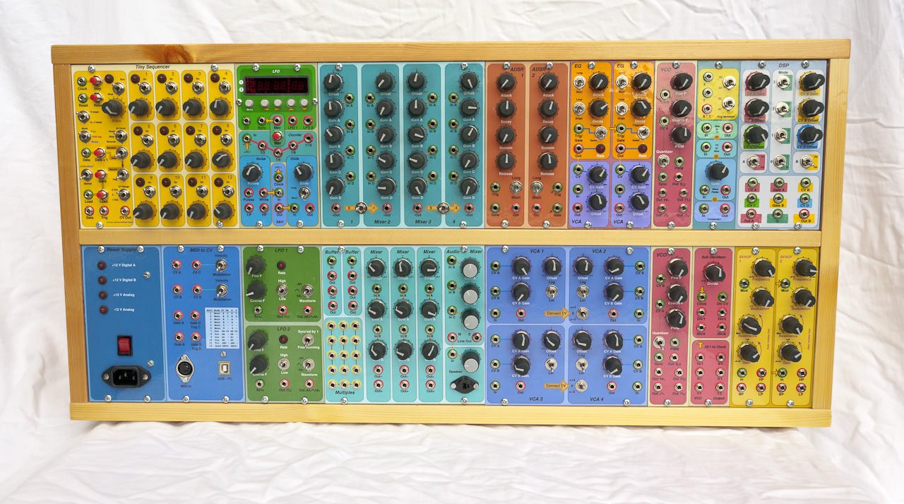

PostPosted: Tue Jul 14, 2015 12:18 pm    Post subject: Reply with quote  Mark this post and the followings unread
Just finished my first rack, all my own design, although some are text-book circuits. One-and-a-half years in the making.
The measurements are non-standard: 16 cm hight and a multiple of 4 cm width for each module.
The modules:
Top row:
- 12 step sequencer with lots of functions
- dual LFO for clocks; counter (2-4-8-16); noise source, sample-and-hold and portamento in one module
- quad 4-input mixer
- dual envelope generator; ADSR
- dual envelope generator (attack-decay) and dual VCA
- VCO
- ring modulator; waveshaper
- digital signal processing module with many options; for example delay
Bottom row:
- power supply
- MIDI to CV (and USB input, but not finished)
- dual LFO
- buffers, multiples, triple mixer and audio output
- quad VCA
- VCO
- sub oscillator connected to the VCO
- dual state variable filter, with vactrols
It's an analog synth, but internally many of the modules have digital circuitry and microcontrollers.
I may present some of the modules in more detail later.
… and I also made a MIDI keyboard.
I have found lots of inspiration on this forum, so much good stuff being made.

Looks like a fun box!

Thanks.
It is. I had a lot of fun making it, anyway.
I can't play any instrument, but I like to experiment with all sorts of patches and make noises. I feel it sort of opens a new part of reality.

Hey guys! I'm new to the forum, but have visited it many times in the past few months on my quest to build my first modular system. I wanted to show off my system now that I have finally finished it! All the circuits were hand soldered on perf board and I used a label maker for the panels and 3D printed the knobs (Knobs are surprisingly expensive!). The filter doesn't have labels unfortunately because I used the label maker at my High School but I just graduated and don't have access to it anymore. I'm now working on my 2nd modular system which is a bit more ambitious because the cabinet is 4ft wide and inspired by the Moog system 35!
I built 9 modules consisting of:
-VCO-1
-VCO-555
-1 low-pass filter
-2 YuSynth VCAs
-1 LFO
-2 Thomas Henry ARs
-1 Yusynth mixer
