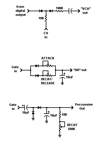

At some point you'll want to hear the results of interconnecting all these digital circuits, and you'll probably want some dynamic control of the amplitude. The first circuit provides amplitutude control of digital waveforms without resorting to OpAmps, OTAs, or (ugh) cmos in linear mode.
Basically, as CV rises, the rectangular wave from the digital output to be heard "stands up" at the junction of the two diodes and passes through the 100K resistor and the coupling capacitor. This method was used in paia's Stringz-n-Thingz and a similiar technique was used in their Cosmic EGG.
Two simple EGs are shown, which don't really need much explanation. Select pot and cap values for the desired durations. The Gate Inputs should probably be buffered by an AND gate with both inputs tied together. If the output is to be routed many places, it can be buffered by a single-supply OpAmp such as the LM324.

Rather than an opamp buffer, would it be possible to use a 4050 cmos buffer?
I think this could be implemented in a general sort of a fashion so it could be used whenever you want to route one thing to a lot a places.

I've thought of a slightly different approach to a "Logic VCA" (LVCA ©)...
Wink
You apply the digital signal to the control pin of an analog switch, and apply the CV to the INPUT of the switch. Now, at the output of the switch you're getting whatever level the CV is at, but turned on an off by the digital signal. The effect is that you get a signal with the frequency of the digital signal, but the level of the CV. The nice thing here is that you can use a bipolar CV and get a bipolar output signal (just don't apply a bipolar signal to other logic; use a diode to chop the negative portion off). I've designed something like this into my version of Ian Fritz's double pulser, but I haven't breadboarded it yet. Might also be fun with a multiplier and/or divider ciruit to get CV control of output aplitudes (and polarity). Like I say, I haven't tried this yet, but I'm pretty sure it would work.
Tim (might be fun) Servo

Pretty cool.
Wink
You apply the digital signal to the control pin of an analog switch, and apply the CV to the INPUT of the switch. Now, at the output of the switch you're getting whatever level the CV is at, but turned on an off by the digital signal. Tim (might be fun) Servo
That's essentially what the 2-diode version does: "chops" the CV at the digital (audio) rate. I hesitate to use the word "elegant" but your way is more efficient, in number of parts and number of holes. And you get four of them from one IC.
I'm not sure about the bipolar aspects, though. Analog switches like the 4016/66 don't have level translation. If you want to switch a bipolar signal, the control signal has to be bipolar too, as does the switch's power.
The 74HC4316 is a quad switch with level translation. It can switch bipolar signals with a unipolar control. Power has to be +/-5v.

Ah, I'd forgotten about the switching level requirements for CMOS analog switches. You're right: on a 4016 / 4066, the "logic" for turning the switch on and off has to swing between the supply rails (or close to it). So if you're powering an analog switch with ±7.5V so that you can switch a ±5V analog signal, the switching input has to flop back and forth between +7.5V and -7.5V. Still, might be worth looking for a simple level shifter for the switching input.
The 74HC4316 looks like an ideal solution. This part is still in production, and can be had for under a buck. Also looks like it would be happiest running on ±6V supplies (still allows switching a ±5V analog signal with 'standard' 0 to 5V logic). I think this would be something worth looking into, as I think I'd want my Lunettas to be able to play nice with my other modular stuff.
The TL60x series is interesting, but they only have one or two switches per package (with only a single control pin), AND it doesn't look like they're cheap. Might not be in production anymore.
If I'm not mistaken, there is a method by which bipolar signals can be passed through the standard CMOS switches without resorting to bipolar supplies. Seems to me, a few years back, Rene Schmitz showed me how to convert the signal to current, pass the signal through the IC, then convert to voltage on the other side. Either that, or I dreamed it. Doesn't Ken Stone do the same thing on one of his modules?
I better check, I guess.......

Hmmm....I guess he's still using -0.6V and 14.4V for the rails, but the supplies aren't too complicated.
I've configured bipolar CD4066s using a dual op amp for the supply. In that case, IIRC, I used two 10K resisors to divide the +15V rail to 7.5V, then fed that to the dual op amp - one section was a voltage follower and the other was an inverting buffer. The outputs drove the CD4066s just fine.
This arrangement of Ken's looks a bit better - you have a wider range to play with, so you don't have to worry quite so much about exceeding the input level.
There's also this method by biasing the signal so that it oscillates around a higher voltage.

Scott Stites wrote:
This arrangement of Ken's looks a bit better - you have a wider range to play with...
That's the other part I don't get. It still looks like a total of 15 volts to me. And more positive than negative at that.
No, actually you can get as close to the rails as the op amp gets, both positive and negative. Remember, with this setup you are feeding current to the op amp - the CD4051 isn't passing the voltage - it's passing the current. It's the op amp that's providing the voltage.
The CD4051 will only see voltage if a switch is opened - then there is no path to virtual ground for the input signal. In that case, voltages lower than -0.6V are shunted to ground. Positive voltages don't matter in this case. Well, as long as they don't go above Vcc, which is 14.4V.

maybe i missed it while reading over this forum, but using the schematics at the top to send to a VCA... is there a simple way to do that? eg an easy circuit in the lunneta style that would take the digital audio signal and amplitude modulate it in accordance with the AR signal?
richardc64
Joined: Jun 01, 2006
Posts: 679
Audio files: 26
PostPosted: Mon Dec 29, 2008 6:22 am    Post subject: Reply with quote  Mark this post and the followings unread
The circuit at the top IS a VCA. Can't get much simpler than a couple of diodes and resistors or, as Mr. Servo suggested, 1/4 of a 4066.

one question, theres a cap in the top schematic, does it have to be a specific value (i'd gues 10uf) or can you tinker with it- it seems so simple yet so delicate.
Posts: 24499
PostPosted: Mon Dec 29, 2008 2:13 pm    Post subject: Reply with quote  Mark this post and the followings unread
It's just DC blocking, so feel free to experiment (until there is enough bass in the output signal).

Hey everyone. I posted this question over at the Deathlehem forum, but wanted to throw it out here, as well...
I'm trying to run a simple 4093 output into the dual-diode VCA. Signal doesn't seem to be hot enough when I check the anode side on that first diode. So I'm running it through a 4049 to attempt boosting the signal. Still extremely faint, but I may have something wrong with my resistors on the feedback loop of the 4049. I forget the math there. Positive my oscillator is working because it sounds fine on the cathode side.
Either way, I need to take a break for a few hours and just wanted to make sure I'm heading in the correct direction and that my theory of simply running the output of the 4093 is not hot enough to be audible through this VCA without pre-amping... or should I just throw an amp on the output of the VCA? 741, etc?
