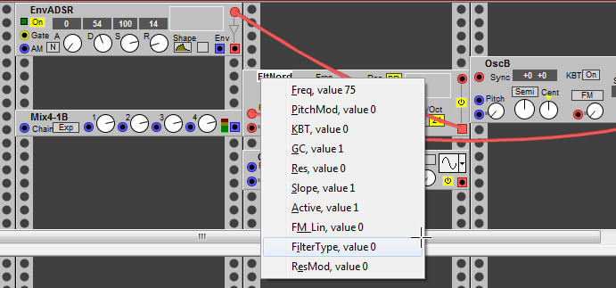

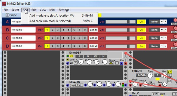

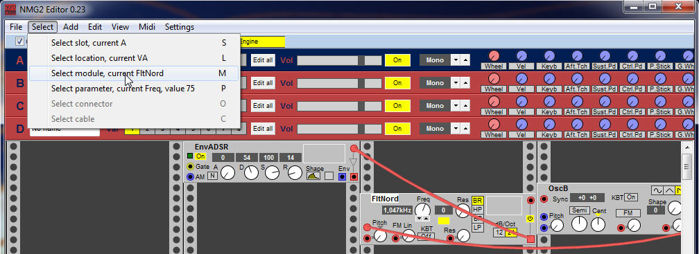

In the mean time I've been experimenting with Jaws and the menu-driven interface. I think it will be quite a challenge to make it workable, but I'm willing to give it a shot.
First of all, there must be no graphics in the menu, otherwise Jaws will only tell you that "context menu item is graphics 614" or something like that
So I've made a global setting "Only text menus", that will surpress all graphics in menus.
In the main menu I've added a menu "Select" and a menu "Add".
With the menu "Select" you can select:
a slot
a location
a module
or a parameter of a module
it also shows the selected value for each menu item, so if you go over the menu items, it will tell or show you for example "Select slot, current slot A", or "Select module, current OscB". In case the parameter it also states the current value, so is says "Select parameter, current FreqCourse, value 27".
When you select the menu item "Select module" in the select menu, you get a popup menu with which you can select one of the modules in the current patch location.
So with the select menu you should be able to select anything in a patch but it also tells you the current selection.
Then in the "Add" menu, you have the options to add a module or add a cable.
The "Add module" option also states where you will add the module, so it says for example "Add module to slot A, location VA". The slot and the location are the ones you selected in the "Select" menu.
I'm still thinking about the "Add cable" option, because that one is the most difficult.
The starting point is the currently selected module. So I think there should be a popup menu with wich you can select one of the output connectors of the selected module, then a submenu with which you can select a module that has an valid input connector, and lastly a submenu with which you can select the input connector of this module to which you want to connect.
So the basic idea is that all the steps of patching can be done with menus and submenus, as you suggested earlier. And I think it's also important that the menus should display the current state of the patch or the selection where possible, and the menus should list the items always in the same order.
That way, hopefully, it's possible to make a mental image of the patch.
I'm only experimenting so far, so if you think it's not going the right way, please let me know.
