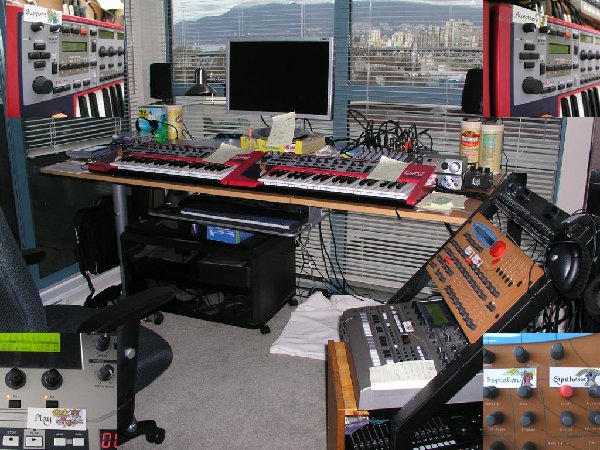

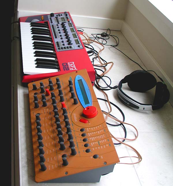

Together at last, my G2's and a Waldorf XT. Finally picked up an XT - and what a combo. The G2 is running lookup sequencers which control the Waldorf notes, both wavetables, and filter settings. Just lush and in your face. I am beefing up the Waldorf xt with a G2 compressor some eq and fx.
Now I can sell the Dave Smith Evolver, as I can get it's distortion in the G2 and the wave tables are way nicer in the XT, and have more polyphony, audio ins, and all those filters.
I'm also running a G2 send and return loop through the XT audio in and bus out for so much more character than the G2 filters could ever give me.
How do folks combine the two? I know there are a lot of you with this combo around here.

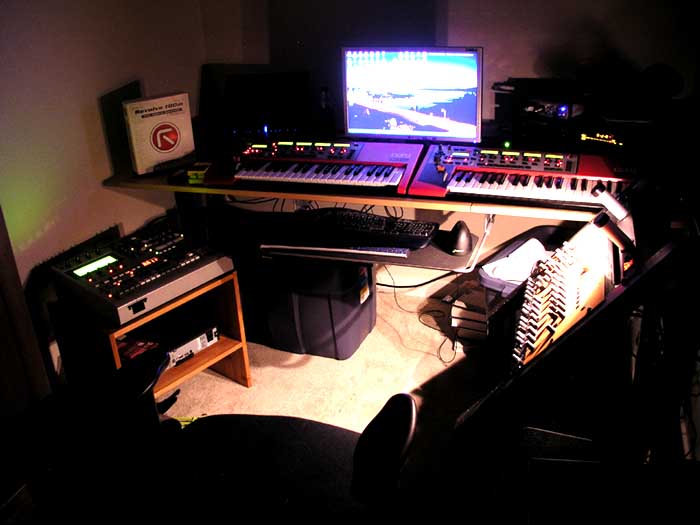

after 4+ years, I have no more gear closet to "hide" my gear in. I am (not pun intended) out of "that" closet and into my own studio room. I am very happy and somewhat reluctant to take a whole room up with my electronics.
here is the picture for elaboration. Notice a copy of Revolve 100m sequencer s/w I produced in the 1990's (eventually for Opcode), Rs7000 (left most)), 2 G2 keys with monitor between them, one DAT machine as A/D for Waldorf xt (right most in rack, with all those 44 knobs)
Damn, this space gives me good inspiration. Good! Share your space for inspiration!

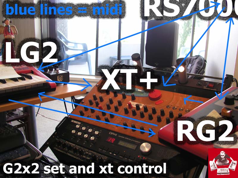

I have a new setup, as I moved my studio recently - again & twice in 2 months (thus my new avatar).
My set is coming along well, but I figured I'd share some of the cool character of the waldorf xt filters with you to give you an idea of their flexibility (for those who do not have a waldorf xt). this synth is soo much worth the price.
Since you can u/l your own wavetables, you CAN create your own filters Wink and how sweet is that Wink
And yes, it is 3 g2 note sequencers controlling the xt.

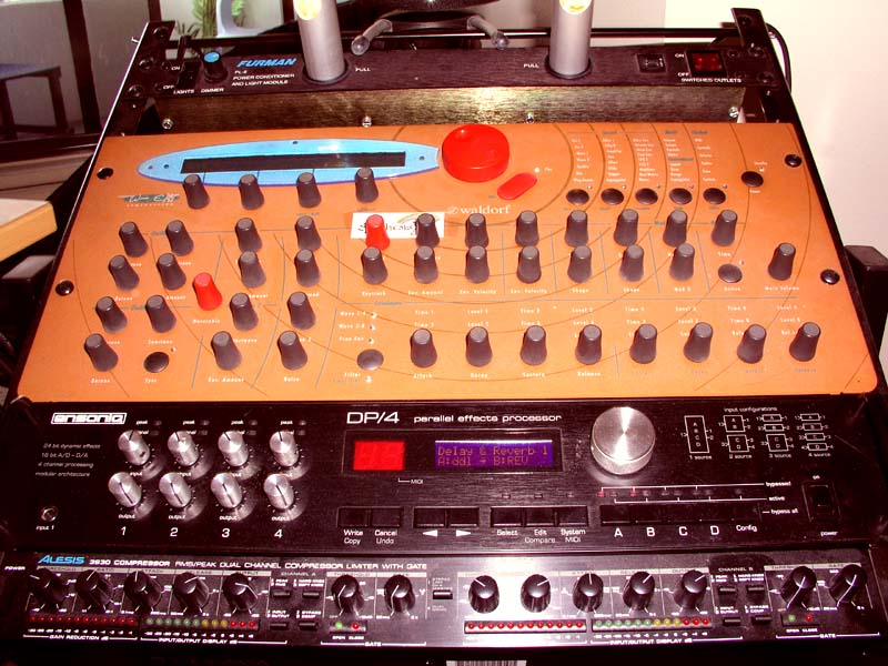

I really love the filters in the waldorf xt. they are superb and rich. but I am especially drawn to the waveshaper filter which uses a wavetable as a sort of scaler / shaper waveform to transform incoming signals to.
So i have a new xt patch which uses the filter envelope to both control cutoff and waveshape
[EDIT - of course to illustrate the effect better, I use standard saw oscillators, and use the wavetables are used to sweep the filter waveshape only, sorry for not making this point earlier]. And using the big red wavetable knob, I keep finding wonderful choices.
now if one was to also apply such a principle to resonance -- i bet it would add character too.
so, dear patchers, here is the challenge, make me a diy waveshaper filter which takes some sort of wavetable (hint use sequencers and mux for this), and modulates them based on some synchronized mods (ex filter env controlling both cutoff and waveshape wavetable, and resonance to select wavetable to control ????)
Am I dreaming or does this make sense? The orange XT says so. It is just a concept.

PostPosted: Sat Dec 22, 2007 10:37 am    Post subject: Reply with quote  Mark this post and the followings unread
thanks g2dream (some would argue you ought to change your name due to the no more OS fear, but for me I dream in g2 modules, regardless of updates)
Here is the g2 patch (very simple btw). the g2 must run on the same midi channel as the xt (and control it). All it does is add some saturation and OD and adds an osc for testing purposes.
the connections are
1. g2 loaded with this patch and output 3 out goes to xt audio in. the xt's sub outs are connected to g2 input 3&4
2. xt has a multi with 2 patches (both on the same midi channel as the g2)
a. Out patch - mixer goes to 2 completely open LP filters (cutoff max, res, 0) this goes to sub outs
b. In patch - all mixer levels off except for external in. You then pass through the xt filter of this patch and adjust & midi control it (if you want to)
Reading about the waldorf Blofeld and it's brilliance parameter drove me to try it out for myself ...
I know there are lots of folks with an xt and a g2 around these parts ... I'd love to hear what you do with them & how you combine them -- with examples. It is inspiration for me and others to hear these ideas to drive us to do new things (call it our internal OS updates Wink )
/Dasz

PostPosted: Tue Sep 23, 2008 1:47 pm    Post subject: Reply with quote  Mark this post and the followings unread
Well, it is now about a year since I got my Waldorf (back) xt. And I must say, the attitude in this beast is from pretty bad ass, twisted glitchy, to space-filling, ethereal, and lush. The really nice addition (thanks to Konketsu from LivePa.org for pointing it out since the unit has sat in my closet until recently) is the 4 input ensoniq dp/4 which serves 2 xt outputs plus a pair of stereo master mackie 12042VLZ3 mixer sends. A nice match of synth and fx.
I must say that I have used it standalone (not controlled by a G2, but by a rs7000) up until this point, but now I am integrating it into dual prf2's which are loaded into each of my 2 g2's to control 1 xt (and other things like the master set control sequences in the rs7000, or a x0xb0x griiinnnn) simultaneously or in parallel.
The xt filter characteristics alone are worth the price (in bundles, IMHO). Not to mention the tone of the wavetables and modulation, and audio input (which is mono, but better than nothing) ... the dp/4's rich reverbs and effects add a dimension that is pure magic. One has to make sure the fx mix is not too high Wink
well, and of course now that I have x0x 853 getting built soon (I hope), and then all madness will be set loose. Kids, please, don't try this with your g2's at home Wink
/Dasz
