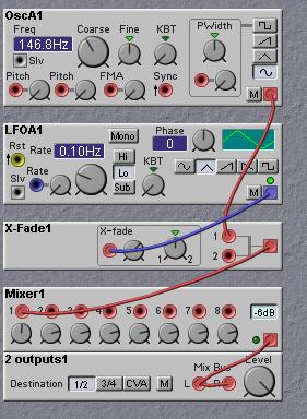

I don't think there's any clipping. The levels in the patch should be OK and I've normalised the audio to -1db. It's actually more pronounced at low volumes, as if it's digitising noise from a low bit depth.
I can hear it on the headphone out and the main out from the MM.
Here's the revised patch, I've made it as simple as possible just to demonstrate the effect. You can see the level on the mixer is right down. The x-fade is just to automate the level of the oscillator.
Patch - http://www.mediafire.com/?zcwguttylio
The audio is a .wav so it's not an mp3 artefact.
New audio - http://www.mediafire.com/?goymkmqzy1d
Recorded at a lower level, hence the hiss, but you can plainly hear what sounds like a square wave with PWM.
Thanks again.

Blue signals act at a 4th of the sample-rate of red ones. When you use them for am (which this essentially is) you'll get stepping at a 4th of the sample rate in your audio signal which is indeed unpleasant to sensitive ears.
In some cases a LPF over the modulation source is a good solution but structurally speaking I think you are better off using red osc's pitched way down for am. If sound quality is dear to you, and it sounds like it is, it pays off to make sure blue signals *never* touch the actual audio without smoothing in place. Often a first order lpf will service to push the errors below the audible, especially in the context of a mix.
This is a especially delicate issue with envelopes, I find, as it interferes with snappy attacks. A variable filter can be used there; I find the exact spectral content during extremely fast attacks doesn't matter so much. However, when you take the filter down again beware that the modulation source for that should likely be smoothed as well. Overall it's quite annoying, and compensating for this can easily take up a quarter or more of your patch. It's worth it though.

It's not that, I wouldn't mind if it was. The duty cycle of that LFO is around 5 seconds or something - it's just there to provide a slow rising and falling level for demonstration purposes, not audio rate AM. I should clarify, this is not an issue with a particular patch, that patch is just a test.
The same thing happens with an osc going straight to an output, or into a mixer module first. It goes away if I turn the physical main volume knob down A LOT, but kicks in again when it's turned up - so it's related to the overall output level.

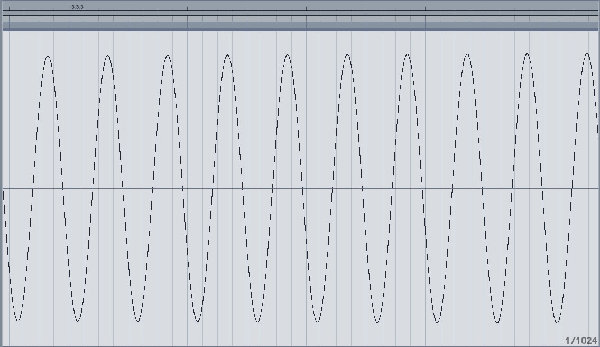

I suspect a broken DAC. The effect reminds me of sounds I got emulating bad DACs in a otherwise anti-aliased system. This gives harmonic (for practical purposes) overtones as the effect will repeat with the cycle of the signal.
Looking at the actual wave confirms this. For the positive half of the cycle there are discontinuities on both the way up and down at the same amplitude. cycles that stay below that level look like decent enough sines, give or take some recording hiss.

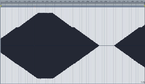

Aha! Here's the problem.
If you look at the nordio2 clip, you'll see that the overall envelope has a weird plateau in it, and once the level passes that threshold, there's clear defect in the waveform. Look at the attachments for more detail.
I don't seem to be able to add more than five attachments; so I'll put the last one in a separate message.
The overall envelope (i.e. amplitude vs. time) for the second sample has a strange shelf in the positive half.

The waveform for the first signal looks normal in the high-level portion too.

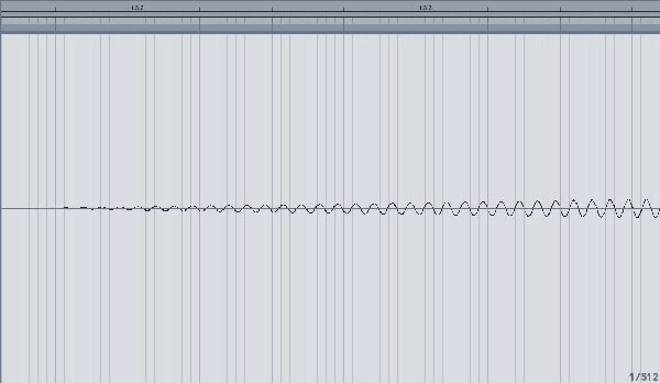

The first signal's waveform looks normal in the low-level portion.

Looking at a small portion of the waveform when it's loud, we see that there are artifacts of some kind in the positive part of each cycle.

Looking at a low-level part of the second signal, the waveform appears normal.

As promised, here's the missing attachment. It shows the overall envelope for the first sample.
The first signal has the kind of envelope you'd expect: It rises linearly until the fader has reached its limit, stays there for a while, then falls linearly back to zero.
