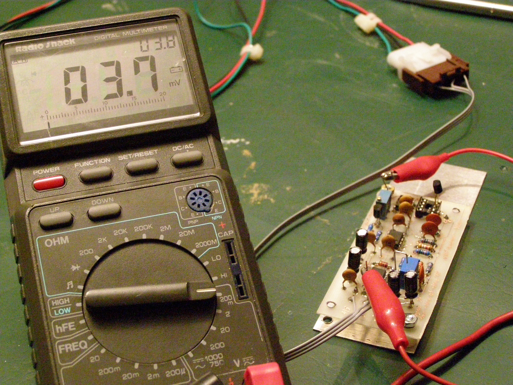

PostPosted: Sun Dec 19, 2010 9:21 pm    Post subject: Just built Ray Wilson's NPN Transistor VBE tester Reply with quote  Mark this post and the followings unread
I really have needed a way to match transistors and I built Ray's (Music From Outer Space) Simple NPN Transistor Matching setup.
I decided to utilize a PCB and I used Eagle to design the PCB. This was my first attempt at a double-sided PCB and it worked out fine!
The only tweek I had to make was to change R12 from 1500 to 822 ohms (for the null circuit).
The module can be powered from my synthesizer supply (+15/-15v) -- I used an 8 pin socket for the test transistor (just using the first three pins for testing).
Now that I have this tester, I have plenty of work to do -- I need to get a matched pair into my Bi-N-Tic filter. I am also building some Yusynth modules that require matched pairs: the Quad VC Panners, Diode Ladder filter, and the Moog filter clone.
Picture shows the VBE tester board and the corresponding readout from the multimeter. The tester is mounted on an aluminum base for stability.
