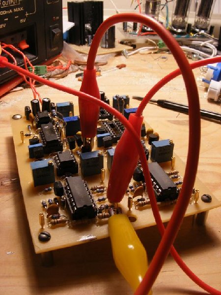

Pantheon
Joined: Feb 17, 2011 Posts: 36 Location: Edinburgh
Posted: Tue Apr 05, 2011 5:41 pm Post subject:
| Sebo wrote: | | The audio pass through the VCF, but if I can make me enough time I will try to dissasemble the synth and inject the signal directly to the VCA. |
Just remember there is no pressure, I would hate to hear that you had buggerd up your MS10 for this.
Well... The parts arived today, and the main board has been assembled.
I have completed it about an hour ago, and couldnt resist firing it up before bed. I tested only one of the two vcos, and it looks like I havent made any assembly errors. The wave shapes are fine, lin and exp fm works, the sync also seems to work.
I'll be able to test it much more tommorow, but the initial signs seem good.
There are a few strange artifacts however, such as a marked sensetivity to the presence of my finger near the saw core. Also, the triangle has a slight negative bias too it, and the gain trim doesnt apear to work.
Hopefully I can get on top of these issues tommorow.
But here is a pic of how it looks on my desk just now

Joined: Nov 02, 2010 Posts: 139 Location: ruhr-area/germany
Posted: Wed Apr 06, 2011 5:33 pm Post subject:
Yummy!
Hope,troubleshooting will be successful. Thumbs up!
@Sebo: Don`t kill your MS...  _________________ Best regards

Pantheon
Posted: Wed Apr 06, 2011 7:06 pm Post subject:
ok, so i've tested both sides now and they both seem to work almost identicaly which is quite a good sign.
Things of note:
- The triangle symmetry looks nice.
- The gain trim actualy works, it just doesnt have a great amount of range, but its sufficient.
- There is a very slight amount of wobble on the output of each vco (maby 100mv or less), that seems to increases with the presence of my finger by the CA3046 chip. I've had this same wobble on each version of the vco, and I havent been able to get rid of it so far. Does anyone think this will be a problem? Its not audible. I think the best I can hope for is that someone else who makes this vco might be able to figure out whats causing it. It might be present on the MS20 for all I know though.
- The saw still has to be biased a little negative for a good triangle symetry, leading to both the triangle and the saw being offset by around -500mv. I know this can be improved by changing a resistor in the triangle circuit, but its ok for my needs, so I dont think i'll change it, sry . I'll point out the resistor when I release the plans.
- Not much else to tell other than I think it sounds realy nice.
So the final thing that I need to do is to etch and test the octave and ring mod board, which I will do tommorow. Assuming that works, I'll post a PDF with the PCB for toner transfer and a small guide on how to tune it in and wire it.
Remember this will be no high end vco, I just want to emphasise that. Though hopefully once it starts getting built by people, some improvements will be suggested. For now, expect something very analoge, warm and with plenty of colour. _________________ the8bitpimp.wordpress.com |
