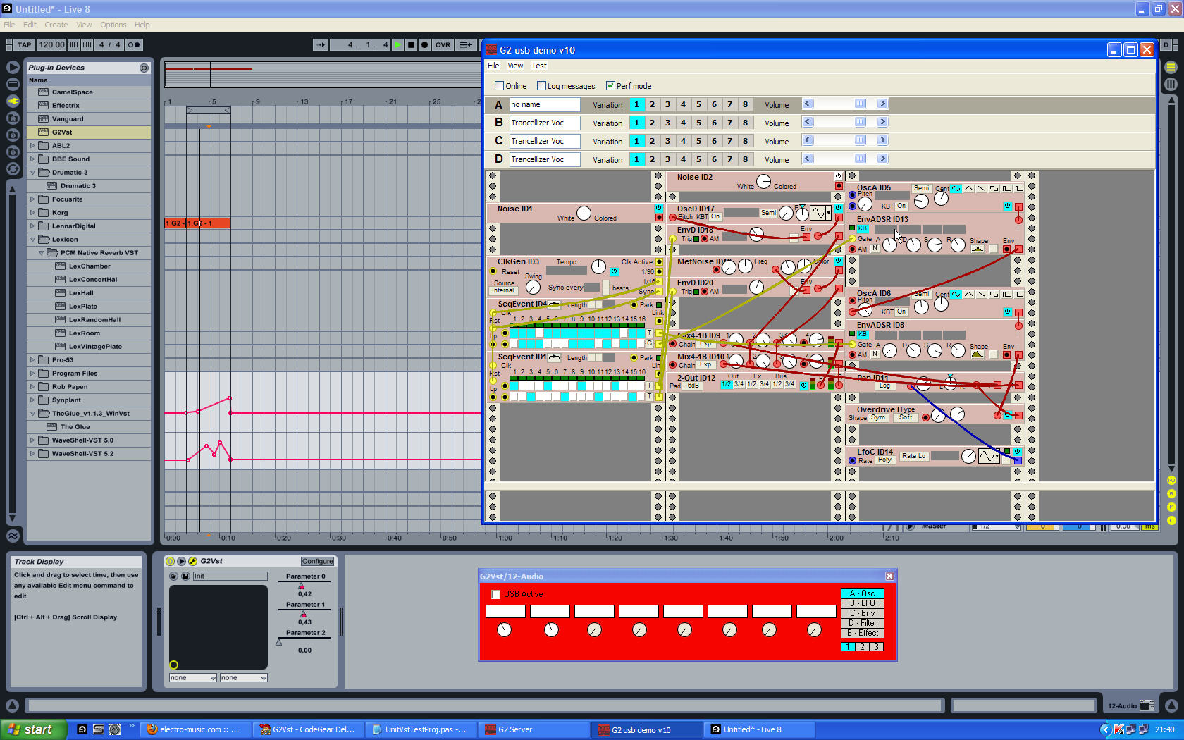

Ok, finally I think I'm getting somewhere... I've made a kind of client-server setup. A server that keeps the USB communication with the G2 and a bunch of clients, can be an editor or a vst, that connect wiith the server.
I use the WM_COPYDATA message to exchange data between the server and the clients. That's a window message, so for the vst I create a hidden window to receive the messages.
So, with this setup you can have multiple vst's running, in for example ableton, from wich to load an save patches and automate parameters. The patches are automatically loaded with the project.
And at the same time you can alter the patches with the editor. I think that is a very flexible setup that may open up a lot of possibilties. I'll have to get rit of all the bugs off course...
Here's a screenshot with one very red vst. Maybe I'll integrate the server in the editor later on.
 Filesize:  483.08 KB
 Viewed:  664 Time(s)

PostPosted: Fri Sep 23, 2011 3:07 pm    Post subject: Reply with quote  Mark this post and the followings unread
Sounds just about right Exclamation
Wondering why you didn't use TCP for communications though ... I think that would make portability easier.

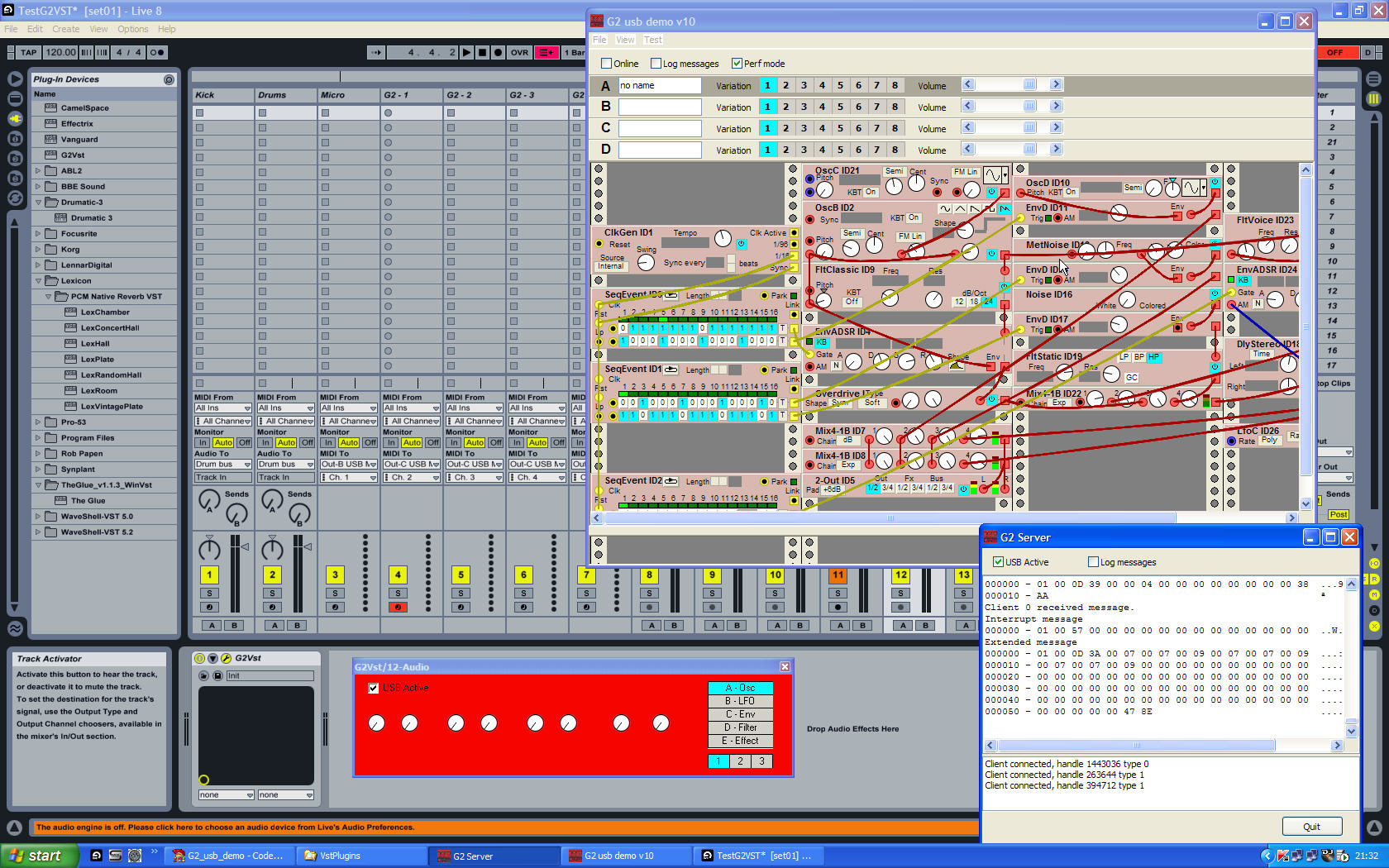

There's not much changed on the outside because I spend a lot of time restructuring, it was all getting too big and too complex.
These three things I mentioned earlyer are now more or less finished. I've got the xml database thanks to Jan.
When I change a parameter or a knob, all the corresponding knobs in all the clients change also. And I've added assigning & deassiging knobs in the parameter pages and these changes are also communicated to the clients.
And the clients get there initialization data from the server in stead of directly from the G2.
So, now I'm working again on the VST. I tried some automation in Ableton, you can see in the screenshot. It works, but it's too slow, it's also using too much CPU.
I'm not at all experienced with VST developement, it's all trial and eror. This VST I have now is just thrown together so I probably made some fundamental errors there. I've to study a bit more and that will take some time.
Don't know if there's someone on the forum that has some more experience with vST's?
 Filesize:  394.21 KB
 Viewed:  317 Time(s)

PostPosted: Tue Oct 11, 2011 2:12 pm    Post subject: Reply with quote  Mark this post and the followings unread
yes, thanks. I've got a lot of info from there. I think I know some of the reasons of the bad performance of the vst:
- The messaging with WM_COPYDATA was a bottleneck, so I changed the messaging to tcp-ip. Now it's behaving much better, but still too slow
- I've a couple of graphical control updates connected to a parameter change event, for example the knob in the editor moves. But Ableton is sending a lot of parameter data with automation. So the graphical updates are eating a lot of cpu. I have to make that more efficient, or don't do any updates of controls at all or maybe sample it with a timer.
- Maybe ableton sends even more parameter data than the usb interface can handle, don't know yet...
But for the rest it's looking good, the vst automatically loads a patch if you load a project and then you can edit it further with the editor and assign knobs for automation and so on while ableton is running.
I hope I'll get the performance problem under control.
