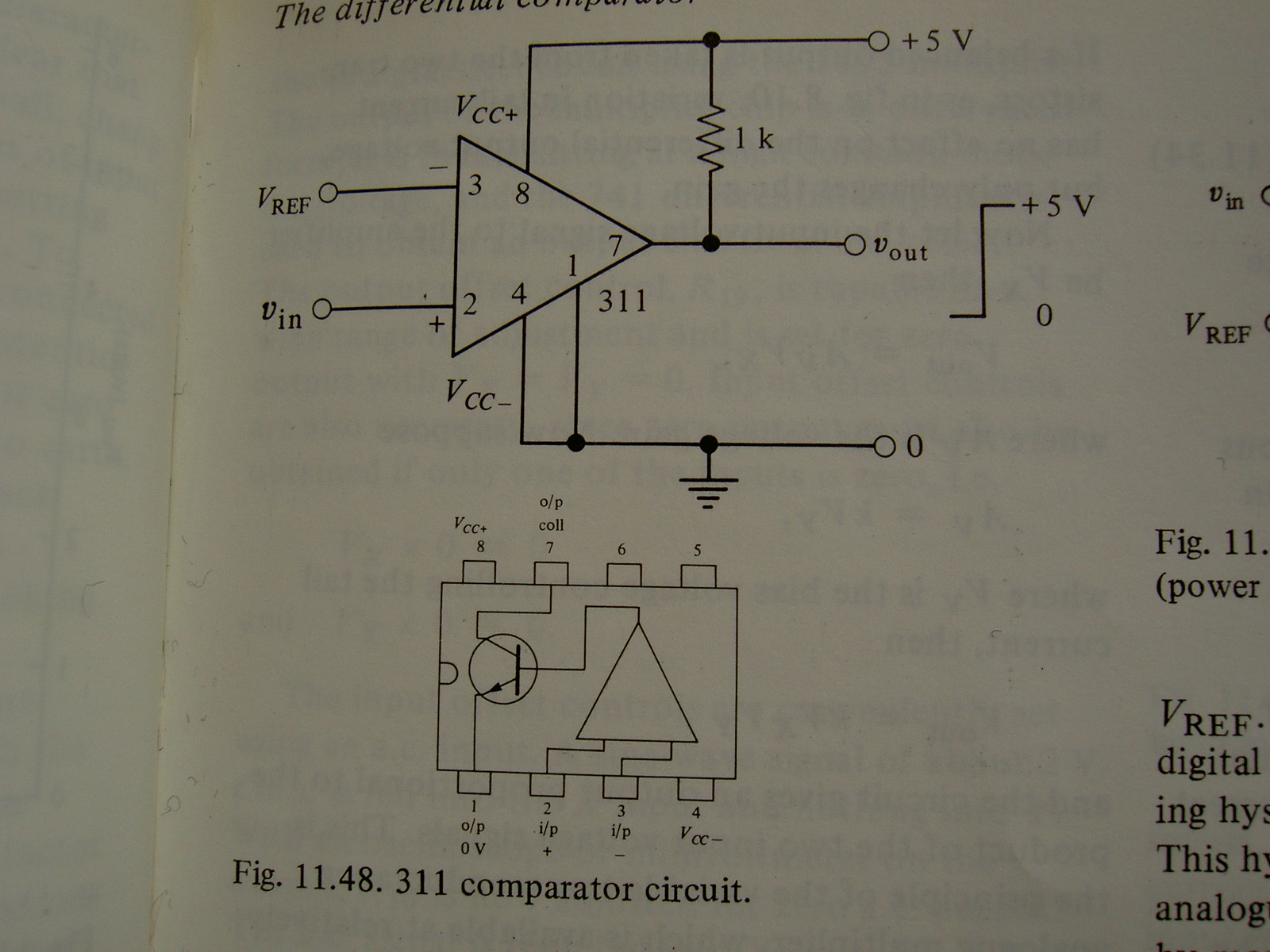

Zipzap,
Can i be so impolite ,here,as to introduce the LM311 comparator chip?
I do believe it could be an asset to you.
Whilst there are chips with 4 comparator blocks,LM339,what is nice about the LM311,apart from being priced cheaply,is the backend.
As your dilemmas of the current droop from last month are still in my mind,this little chip has a medium power transistor on the output,in fact it is a fireblower,pushing up to 50mA.
It can handle between +/- 17V on 18Vpower rails on the input .And can have the output transistor supplied off a different supply,so it could just fire out 5V if required.
I have enjoyed the pin 1 and pin4 to -15V,pin 3 ref,pin2 input,pin8 +15,pin7 is output and collector and as such is tied up to 15V with 1K.(Take it to 5V for etc.)
I don't imagine you'll need it here,but perhaps those event timers over at Peter Grenders might set you off....

the pin 1 of the 311,goes to 0v,7 is pulled up to +15 or +whatever gate you want.that sets the output range,pin 4 can go to 0v if you are comparing above ground or to -15V etc for zero detection etc.
er...that needs a photo now...
(my digcamera is excelling itself for some reason)
Robert

Hey Robert - mighty thanks for pointing towards Peter Grenader's site - I'd heard of him many times but never actually seen the site and there's really great circuits there. ACE IN EXTREMIS.
...hmmm, I've always just had the logic chips pretty much unbuffered (though may be good at the output) -- and just thought that a simple way to get around the amplitude drop problem would be to put the signal through another invert buffer like you're using for the original squarewave oscs..?.. (..I'm often only using a couple of the hex-inverter gates, so using up an extra one would be easy..)

This site is great! I´ve been there once, but hadn´t noticed how cool those circuits are! That delay seems great. i have to go for it!
Useing another inverter might not work when you drop the voltage below half the supply voltage, which as far as i know is the minimum level for a high signal. So a comperator is propably the right way.
I just added the buffer because i always do that. As long as you just drive some high impedance (buffered) input it´s not really needed. 1k at the output of the cmos chip is propably enough to protect it against overload anyway.
