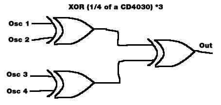

just got this from an old book. Looks fun so i want to tell you.
They call it heavy metal machine. It should sound like cymbals or banging against the body of a ship.
Take 4 indepandant square oscillators, send each two into an cmos-exor gate, send the two exors into a third exor. (hope that was clear)
than process with vcf/vca/adsr.
Haven´t tried it yet, my workbench is so full i can´t touch anything.
Should be nice with voltage controll for the square generators. Maybe just for one or two of them.
Maybe at slow speed this can create interresting trigger patterns.
cheers

I built one of those. with one vactrol vco. Here´s what it sounds like.
In the meentime i gave it two hand controlled vactrol oscs as well. Huge fun.
Would like to hear them starving a little. How should i do that, when they use the same psu as my other modules? The CMOS chips use +12v and ground, the led driver and the Output opamps get +12, -12 and ground.
So i guess i just put a voltage divider like some 100k pot to the cmos chip supply? Anything to whatch out for?

For low power I just starve the digital chips by placing a 1M lin pot across the power line (but only the power for the digital chips!). At low resistances this works pretty much as a tune control, but things go wierdy at high resistance (where power is really starved) - the only thing I think to watch / be aware of is that 'cos the chips are getting low supply voltage, the output waveforms have a lower amplitude ('cos they swing from gnd to +ve supply voltage) -- so 'volume' (level) goes down when the chips are starved.

Maybe we could use a dual Pot with some aditional resistors. One half starving the chip, one half controlling volume. I´m gonna try and check this out. I also thought of voltage controlling the starving with an opamp powering the cmos chips. Maybe it´s fun, maybe not really.
zipzap
Joined: Nov 22, 2005
Posts: 559
Location: germany
PostPosted: Wed May 31, 2006 4:30 am    Post subject: Reply with quote  Mark this post and the followings unread
Just gave it a try. this is fun!
Slight modulation of the power sounds really great with changing overtones, at very low level i get just clicks, sometimes random, sometimes in a cool pattern. good for clocking, triggering, whatever.
About the volume: Even when starving the chip, we are still dealing with logic square pulses here, right?
So it might work to have some comparator thing to get an even output voltage (should be dividet down of course).
Right now i have a tl084 as an voltage buffer out for osc 1+2, 3+4, 1+2+3+4 and 4 (can make cool stereo sounds that way). All i have to do is disconnect the inv. input from the output and put it to ground instead. Am i right there or do i miss something?
Then next i´ll see if this sounds the same when a opamp is used to power the cmos chips. Power should be no problem, since it´s only two chips, but i guess i have to do something so that the voltage can´t go negativ.

Is this a stand-alone device or part of a module?
Can you post a schematic or a link- I'm not seeing it. Sounds great.

Ahh i finally breadboarded one of these.
I build it with 2 joysticks controlling the pitch of the 4 squarewaves.
My joysticks have only 10K pots, i would have liked 100 or 150, but the sounds are cool. When i build the final version i think i will put slideswitches with little banks of different capacitors for each oscillator.
those of you who have build one should try to put a solar cell (NOT a photoresistor) in series with the supply voltage. The frequency of the oscillators are depending on the supplyvoltage, so you can "modulate" all 4 oscillators by moving your hand in front of the solar cell. The credit for the solar cell trick goes to the guts from Chromatic Field and their solar modules check it here: http://www.sciss.de/chromaticfield/texts/modules.html
What value potentiometers and caps are you all using ?
fldrvr, hard to tell... It´s a module, part of a synth, by itself not that useful.
If you read the first post you´ll find the description how the sound is generated. If you can´t follow tell me, i´ll paint a napkin.
But anyway that´s only what makes the noisy sounds (all the time). So as a standalone unit you want at least a simple vca, (hand-)trigger and decay envelope.
The sound examples were made with a sequencer controlling pitch and gate.
Hey mikmo, hope you´re having fun with this. Joystick sound´s perfect. If you still got it on breadboard try controlling two of the oscs with indeoendand ldrs. i loved that. Have to check that solar cell stuff. I´ll read the link you posted.
Although i´m not sure, i belive the supply voltage doesn´t affect the speed that much if you use cmos-gate oscillators. It´s something different happening, makeing them just go weird. Anyway that doesn´t matter, if it sounds right...
I´m using 500k and 1meg pots. i put the ldr in series to the pots, in other words: it doesn´t matter what you do. Cabs are around 10-100n i think. Those 10k pots are a bit low, if you don´t mind the extra work you could use the joysticks to controll 4 vactrols with high resistance range.
Or maybe just a larger cab will give you god range.

Well.. honestly it is a bit above my head and the project sounds advanced for my currently meager abilities. I'm sure that any explanation you offer would help out everyone, though.
PostPosted: Tue Aug 01, 2006 7:01 am    Post subject: Reply with quote  Mark this post and the followings unread
The Oscillators could be any square wave source, e.g. 555 or schmitt trig astables.

exactly. so any of the oscs from your other post will work. It´s also possible to use the outputs of the first exor gates. They sound different, less complex.
Don´t worry, this is not as advanced as the sound it produces, so you´ll manage.
An exor is a special type of logic gate. Like the and gate and all the others. Check your library for the cmos cookbook by don lancaster. This was all above my head till i read that book (3 times).
So you have two square oscs. What do they do? Turn on and off. Thats high or low - 1 or 0. Thats digital logic signal. So it can be prozessed with logic gates. xor means exclusive-or. The 4030 is one of those. That means the gate compares it´s two inputs. If they are different it´s output goes high. In all other cases the output stays low. So you get a complex(sounding) pattern out of the even on/off of the square oscs.
In this case you do the whole thing twice and send the outs to a third exor. Makes it even more complex. To start with you can try the whole thing with 2 square oscs and 1/4 of the 4030. Then build up the rest. Can you follow?

I think i will first try to experiment with larger ordinary pots and LDR's, and then try to find joysticks with larger resistance.
I tried running the circuit with supply voltages ranging from 3V to 9VA (+ the solar cells ca. 2VA). At lower voltages the pitch seems to be lower. At least the sound is very different. So an adjustable suplyvoltage might prove interesting.
One other thing i thought of, is to send the signal (either before or after the XOR's) to a 4040 octave divider IC. The 4040 has in input and i think 12 outputs that will be the input freq. divided by 2 / 4 / 8 /... /4096. So if you make the Oscillators run at a relatively high freq. you can get a whole series of of "Sub octaves".
Since a squarewave is basically "logic fluctuations" ( or 0's and 1's) it ought to be possible to send it through many of the logic IC's. Some of them might produce interesting results. And most of these IC's costs very little.
