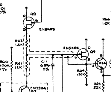

PostPosted: Fri Nov 23, 2012 3:59 am    Post subject: Reply with quote  Mark this post and the followings unread
Hey guys,
On the picture attached there is a dashed line surrounding R61 & R61. It is connected to the junction of Q9 and R64 as well.
What is it ??
Can it be left out of the circuit?

PostPosted: Fri Nov 23, 2012 4:04 am    Post subject: Reply with quote  Mark this post and the followings unread
xpmtl wrote:
Hey guys,
What is it ??
x.
Its a shielding ring, and yes - you can leave it out.
