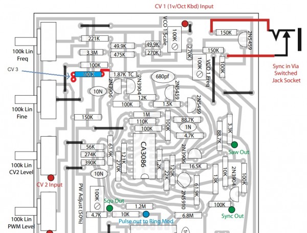

as i understand i have only 2 CV inputs.
1 for the 1v/Oct Kbd.
the other is free to use.
if i want more cv inputs can i connect it like i did in the pic?
(red lines, blue resistor)
thanks.
 Filesize:  208.46 KB
 Viewed:  1165 Time(s)
steffensen
Joined: Jul 11, 2012
Posts: 103
PostPosted: Sat Sep 22, 2012 2:15 am    Post subject: Reply with quote  Mark this post and the followings unread
I dont see why that wouldnt work.

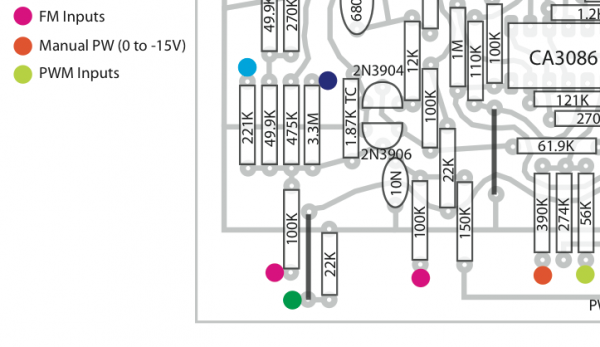

However, when you look at Andys dual VCO version, he put the other FM input elsewhere - see pic.
 Filesize:  89.54 KB
 Viewed:  1227 Time(s)
