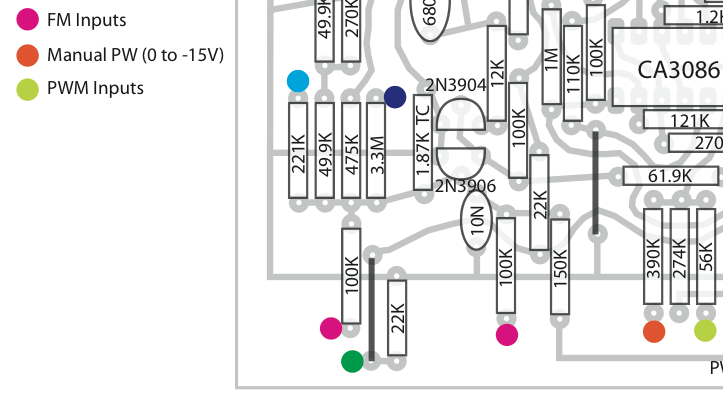

Ive just built 2 boards with this latest BOM/PCB, and i have some issues.
The VCO is VERY high pitched, and dont react much at all to the scaling, no matter how much i turn the Trimmers.
I have checked the resistor colorcodes twice, they all check out. I have even measured with a multimeter the extra resistors i had from this build (i always buy som extras of everything i build) and they all show the correct values.
Also, for the VCO-board im troubleshooting, i have put a jumper between the 150k and 100k Sync pads, as its meant to be the master VCO.
I have gone by the BOM for everything, but still this happens. No idea what can be wrong here.
Capacitors:
680pF Polystyrene - http://se.mouser.com/Search/ProductDetail.aspx?R=23PS168virtualkey21980000virtualkey23PS168
1n - http://www.electrokit.com/pc12-1-nf-50v-poly-5mm.42812
10n - http://www.electrokit.com/mks2-10nf-63v-5mm.42821
100n - http://www.electrokit.com/mks2-100nf-63v-5mm.42658
Ive seen people having problems from time to time with the 4011, so its worth mentioning that i use the CD4011BE.
From Andys pic, i noticed his trimmers are the oposite way around from the BOM, not sure that could mean anything tho.. havent tried that yet.
I really cant figure this out.. Any ideas on what to try?

How important are the resistor values?
I mean, i noticed during my troubleshooting that i had a few that wasnt spot on.
91k instead of 88.7k
12.1k instead of 12k.
219k instead of 221k
472k instead of 475k
I presumed they were close enough, but as i really cant find anything else that might be wrong in this build, im reaching for anything.
Also, what kind of voltage would the trace between the tempco and 475k, 49.9k be at? My measure around that part seems a bit odd.
Anyone? Please?

Thanks, im going deep in to this. Gone thru it all by now, several times.
I have built 2 boards, with the same problem on both. A buddy of mine have built 1 board, that also have the same problem. We use the same components however, so there might be something wrong in there.
Tho - all the components seems to be fine. The odd resistors mentioned were the only things i could find that stood out.

as i understand i have only 2 CV inputs.
1 for the 1v/Oct Kbd.
the other is free to use.
if i want more cv inputs can i connect it like i did in the pic?
(red lines, blue resistor)
thanks.

steffensen
Joined: Jul 11, 2012
Posts: 103
PostPosted: Sat Sep 22, 2012 2:15 am    Post subject: Reply with quote  Mark this post and the followings unread
I dont see why that wouldnt work.
However, when you look at Andys dual VCO version, he put the other FM input elsewhere - see pic.
 Filesize:  89.54 KB
 Viewed:  1249 Time(s)
isak
Joined: Dec 13, 2009
Posts: 847
Location: Israel
Audio files: 18
PostPosted: Sat Sep 22, 2012 3:16 am    Post subject: Reply with quote  Mark this post and the followings unread
if you look closely you will see the dual ver and the single ver FM outputs are from the same spot Wink
now i know it will work Smile

A mate of mine just gave me something to think about.
I got carried away here, thinking a Eurorack version meant 12v, but now after looking around here, i dont see anything like that mentioned. This might explain my stuck on high pitch issue.
So AndyR1960, do this really work on 12v, as eurorack usually do?
steffensen
Posts: 103
PostPosted: Fri Oct 26, 2012 11:55 am    Post subject: Reply with quote  Mark this post and the followings unread
Not sure why i keep posting here, this thread seems to be pretty abandoned..
However, just wanted to update my effort of getting this thing to work on 12V. I managed to get the pitch down from the 2khz droning it was stuck on.
Now its lowest is at around 120hz instead, which is a lot easier on the ear heh.. (still not low enough tho imo)
I swapped the 2N3906 that i used instead of the 2N5910. Used a 2N4125 instead, and that worked a lot better.
It still wont track that good tho, its half a octave off more or less.
Tried swapping the 680pF with higher and lower values. 1000pF tracked a bit better actually (and lower in pitch - nice), but it still was off by at least 1/3 of a octave or so..
I even tried 6800pF, and that went really low. Razz Same tracking as with the 1000pF value tho.
I have a bunch of resistor to swap next, just hoping that someone might give some more ideas on what else to try/look for?
