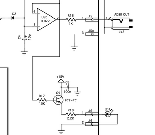

PostPosted: Thu Dec 29, 2016 11:30 am    Post subject: Reply with quote  Mark this post and the followings unread
to wackelpeter
it's interesting that you pointed out LED's current consumption.i'd never have thought of it. For example, an ADSR module i built has one LED.
Very cool to have the light go brighter and duller according to the modulation innit ? Cool Cool
yet it can cause some problems.
what would the cure be ?
lets' take as example the wonderful Yves Usson take at ADSR. I selected the LED region, and it shows a 2.2 k ohm resistor is series with the led.
by the way i truly love this circuit Wink
 Filesize:  19.34 KB
 Viewed:  13615 Time(s)

PostPosted: Thu Dec 29, 2016 2:22 pm    Post subject: Reply with quote  Mark this post and the followings unread
Don't really got what you're meaning. Do you hear some pitch changes in your VCO when the LED goes on and off?
As long as you don't have any pitch changes there is no real need for a cure...
But i might add, that if you have a few of these blinking lights around your cabinet the currents add to each other and the sum then could cause some voltage drops which might be audible...
I for example would just hook a multimeter in the path between the resistor and the anode of the LED and would measure what current it draws when at brightest state. (As i don't have this module here i cannot say if there's much room to get it lightning with lower current consumption. It also depends on if you're using low current LED or a normal LED)
Then if i think there's some room to get lower i would try to add a small 10-50k pot in series and play around with it until i have some better results (with lower current) and the LED still matches the state of the ADSR.
Maybe it's useful to use low current LED's in general as they only need roughly 2mA because normal LED's need a lot more... Don't know what kind of LED's you're using but when those are normal LED's maybe there's little room to minimize the current...
BTW. at my retailer 5mm 2mA LED's do cost the same as the "normal" ones and the brightness is a bit less but i always managed it to get them blinking bright enough and still drawing minimal amount of current.

thanks wackelpeter,
well, i haven't experimented a pitch fluctuation on my VCO . My ADSR has a "regular" LED. However, you grabbed my attention when you mentioned the low current LED's (which i didn't know about) ,or the nice trick of placing a resistor in series (after measuring current and playing around with the pot as you describe). I am interested,obviously,in whatever trick is there to keep the modules current drawing as low as possible, hence my quest for "a cure".
