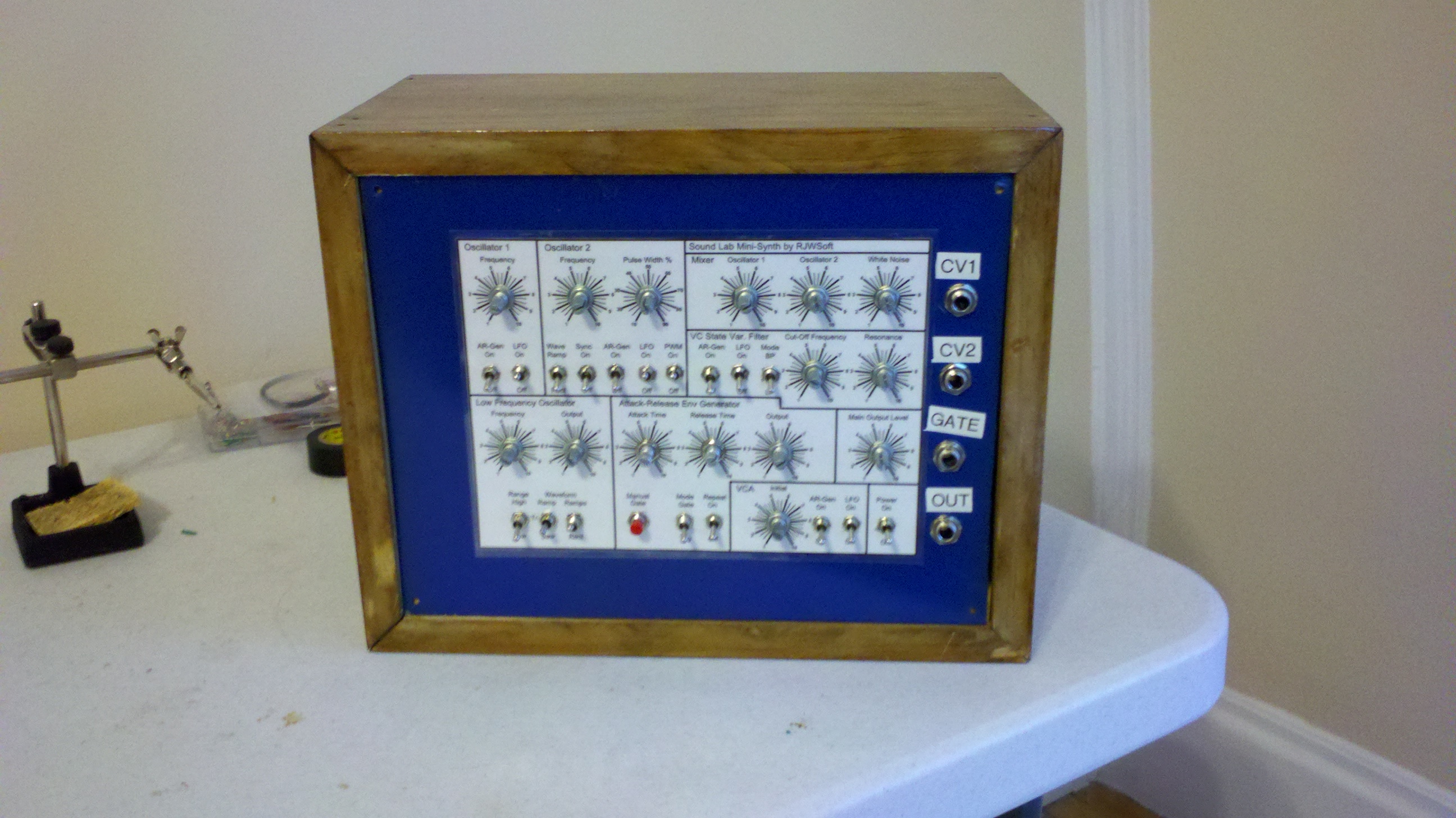

Finished a MFOS Soundlab Minisynth!
Everything seems to be in working order except for the AR generator, which doesn't seem to act quite right.
You'll have hours of fun with this Smile http://www.electro-music.com/forum/topic-39555.html , and i heartily reccomend blue colours on diy synths & gold , heh Smile
Great work , hope you iron out the A/R fault , usually something simple.

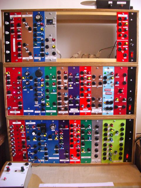

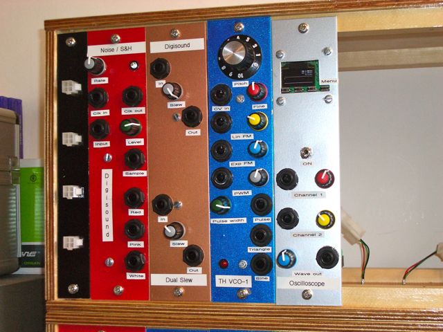

Okay, high time I unveiled the project that has been keeping me occupied for the last 18 months - behold The Mightier Mirlitzer (I prematurely named my Sound Lab 'The Mighty Mirlitzer' and now have to go one better):

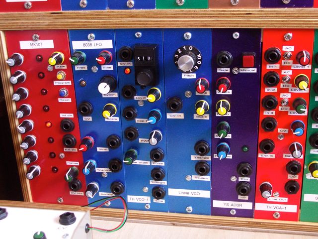

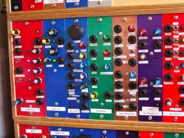

The design criteria for 'The Mightier Mirlitzer' are as follows:
1. Keep it simple. Some of the modules are primitive but effective.
2. Each cabinet is approximately two feet wide and accommodates 8.75" (5U) panels. Standard panel widths are in multiples of inches (2" is the norm).
3. Each cabinet contains its own individual power supply giving +/- 12V at 1A (12V transformers are easier to find surplus than 15V ones). A power supply failure will only take out one cabinet, and each supply is sufficiently overrated to power a second cabinet in an emergency. In a REAL emergency, two 12V gel cells will do the job.
4. Each cabinet can play autonomously, containing at least one 'player' module (sequencer, pattern generator, S&H etc.) and at least one oscillator. Thus, individual cabinets can be extracted for demonstration or live use.
5. The MM is DIY down to the component level. Each module is built on stripboard or homebrew PCB. You can see that the front panels are colour-coded and no expense has been spent.
6. I have a 2' 6" wide gap between desks in my tiny home studio, in which fits a cheap veneered TV table. The MM is being erected vertically upwards from there. I figure I have room for six or maybe seven cabinets at a pinch. Two-and-a-half are filled (see photos); one will be a big sequencer and another one will be a Lunetta, offering both sound and timing signals for the rest of the monster, as well as operating stand-alone.
7. Eventually, the MM will meet the definition of a 'monster synthesizer', namely, if it falls on me, it will cause death or at least serious injury. Twisted Evil

...behold The Mightier Mirlitzer...
Love it! Very Happy

I forgot to mention that I used quarter-inch jacks because they're cheap, robust, reliable, compatible with everything else in the studio, and you can buy ready-made patch cords cheaply in a variety of lengths and colours. After all, who would want a black synthesizer? Wink
On the other hand, the Lunetta will use phono connectors. They're cheap, robust, small and can be connected with a bare wire and a matchstick in an emergency...

that sure is puurty!
yes , wish i had thought of using those first up.

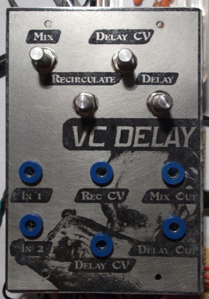

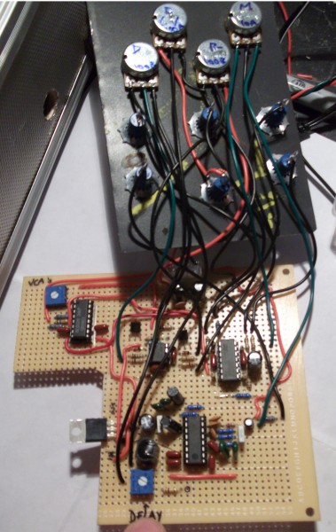

Finished Scott Bernardi's VC Delay circuit. So much fun so far!
http://www.youtube.com/watch?v=W17-Z0nMmx4
that's exactly what I love about it,. the colors. Not that I don't like black,
but there's something about the combination of the colors, incl the knobs,
that I really like. It's like it brings back some sort of memory but I don't
know what memory. Smile
Coooool artwork. How do you label the panel?
Thanks! That's my dog Boris in the picture. I actually used the same toner transfer method that I use to etch circuit boards and panels. I just printed out the reverse image from a laser printer on to a piece of magazine paper. Then ironed it on the piece of sanded smooth aluminum. Threw on a couple layers of clear coat and it turned out pretty well. Not as deep of black as I wanted but I like it.

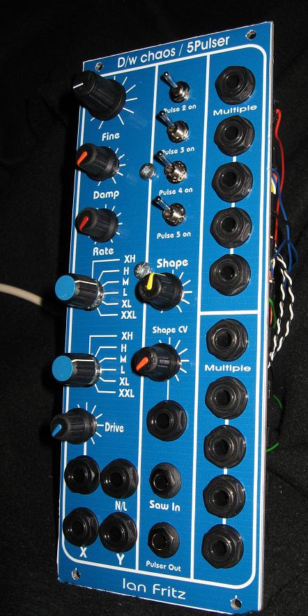

Fritz D-well chaos & 5Pulser & multiples module.
Hello , here are some sounds from these great circuits from Ian Fritz, i use the 5Pulser alot in my recent music & the chaos sometimes for unusual lfo type modulations.
Dave.
Impressive synth you have there , good work & nice and colorful .
Do you use lots of multiples or did you build mini mixers into the designs ??

skrog: that 5pulser sequener and lfo sampler is amazing! Shocked Very Happy
