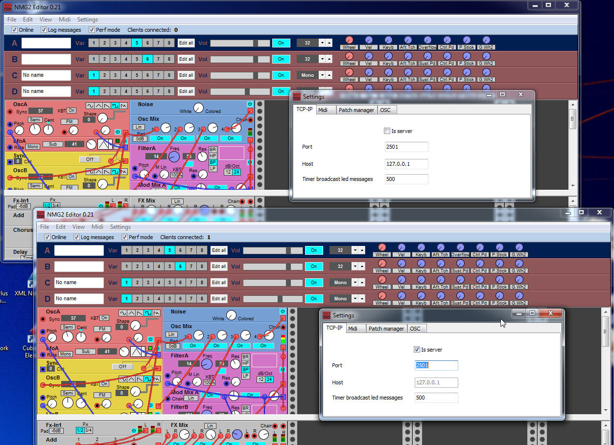

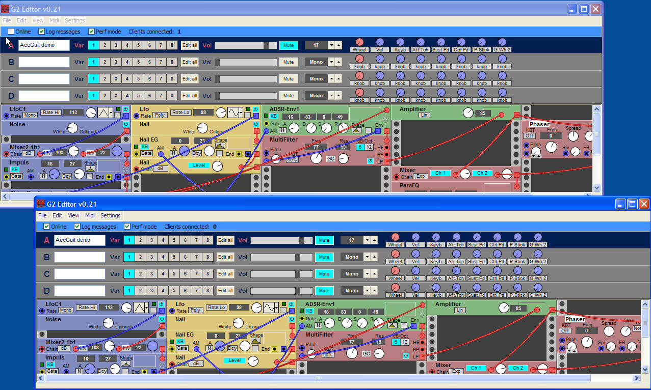

PostPosted: Thu Feb 16, 2012 3:33 am    Post subject: Reply with quote  Mark this post and the followings unread
I have a setting in the editor "IsServer" that is hidden in the current version of the editor, but that allows for the exact thing you are proposing here.
The software was set up with the idea to have multiple clients, vst's or editors that communicate using TCP-IP to a one server program that has the physical usb connection with the G2.
I'll put the editor "IsServer" option in the settings dialog of the new version, so you can experiment with it.
Here's a screenshot with an example. I'm at work right now (or should be Smile ), so it's a bit cramped, but the upper editor in the screenshot acts as a server and the bottom one is a client.
So every change made in either one of them is reflected in the other one, and communicated to the G2 over usb by the server. I haven't tried it out on a wireless network yet.
 Filesize:  306.81 KB
 Viewed:  261 Time(s)

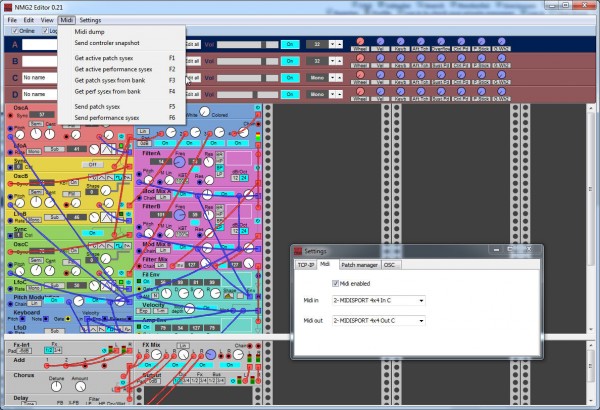

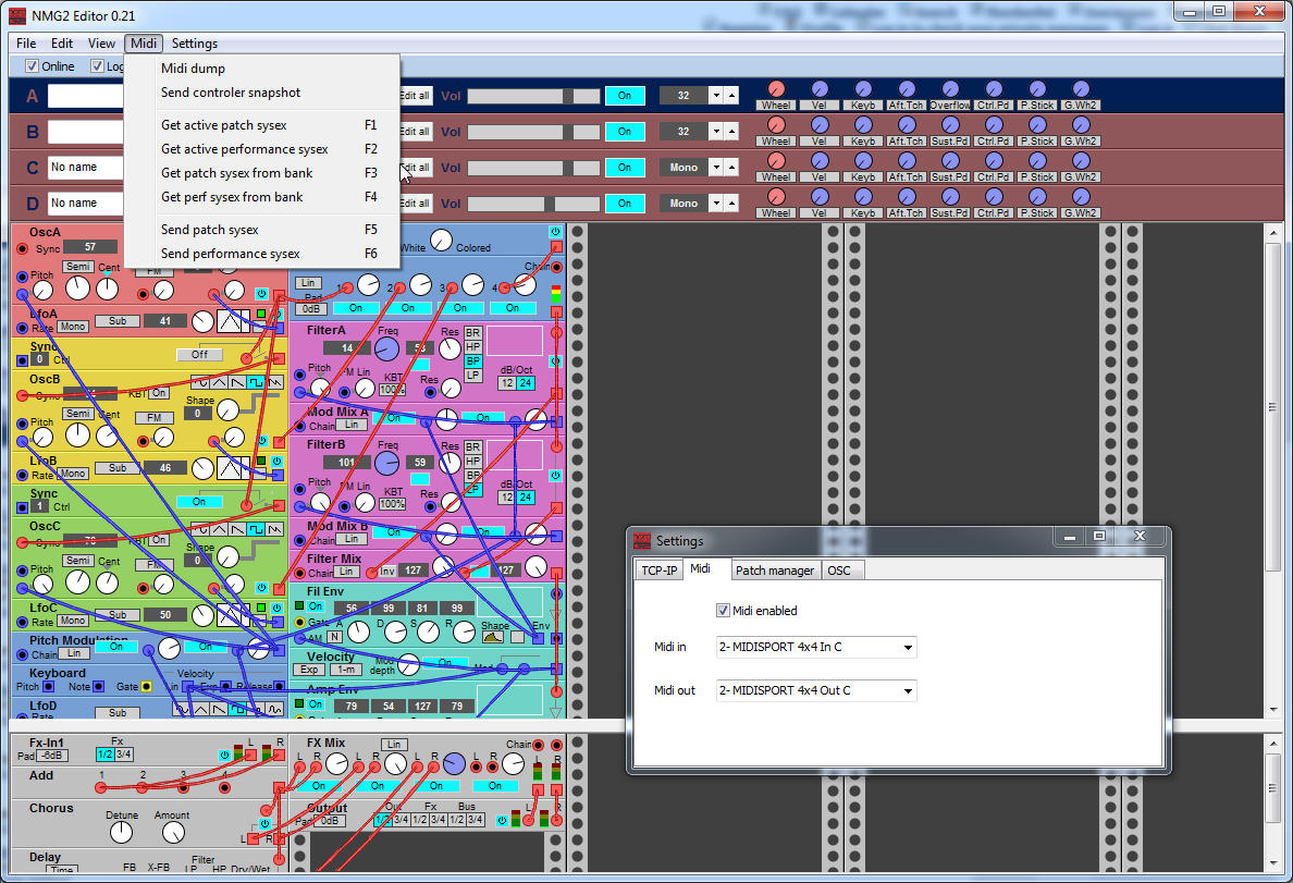

PostPosted: Sun Mar 11, 2012 1:59 pm    Post subject: Reply with quote  Mark this post and the followings unread
I've made a new beta version 0.21. If you want to test it, you can download it from the sourceforge page. It has a zip file with only the executables (bin), or one with the complete source code (src).
Some of the changes are these:
- I've added some midi functionality so you can use the editor without a usb connection. It has less functionality of course, but you can upload/download patches with it using sysex. You can also make patches and download intermediate results to the g2 using sysex. One of the screenshots below shows the menu options for midi and the midi settings tab on the application settings form.
- Also on another tab of the applications settings form you can configure the editor as a client to another editor. You can see that on the other screenshot. You could for example have the client editor on a laptop wirelessly connected to a pc that runs the editor using usb. While testing I found that the led- and volume indicator data is too big al load for wifi, so I made a setting on the settings form with wich you can set a timer interval for sending the led data ("Timer broadcast led messages" on the server editor).
- Also spend a lot of time making the VST compatible with Cubase 6. Cubase is a lot more demanding than Ableton, had a lot of troubles with lock ups of Cubase. I hope a tackled most of the problems, but not quite sure.
- Some other bits and peaces, you can read some more in the readme.txt file.
Hope I didn't make too many mistakes in this one.
Regards
Bruno
 Filesize:  271.28 KB
 Viewed:  193 Time(s)
 Filesize:  320.88 KB
 Viewed:  192 Time(s)

PostPosted: Mon Mar 12, 2012 1:54 pm    Post subject: Reply with quote  Mark this post and the followings unread
Awesome work, Bruno!
I tried the sysex feature but the editor lists devices I don't have in the midi in list (UM-ONE, DJ console and Midisport 4x4). The midi out list seems to be OK, though.
Albert
brunov
Joined: Aug 03, 2011
Posts: 227
Location: delft
PostPosted: Mon Mar 12, 2012 2:20 pm    Post subject: Reply with quote  Mark this post and the followings unread
Ha, you're right! That's strange, those are my midi devices of course.
Probably my settings where saved as object properties and are now part of the executable Sad
Maybe restarting the editor helps or otherwise you could have a look at the "G2_editor_ini.xml" file, maybe edit the "midiInDevice" "MidiOutDevice" attributes.
Meanwhile i'll have a look at it, also just found another bug: sending some note events while midi is enabled crashed the editor.
