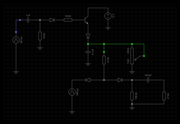

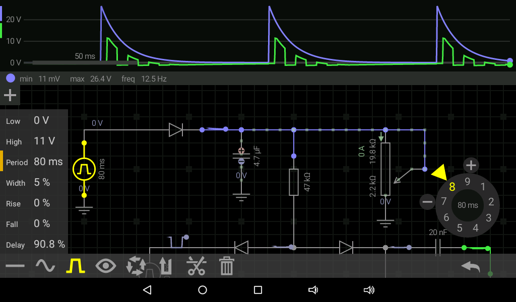

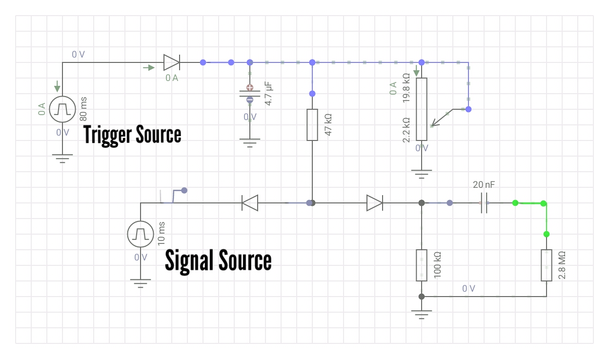

I wanted to try out the minimal configuration that would yield usable results. The attached images show the simulation results and schematic for a very basic VCA implementation which seems to work well ( at least on the simulator! )
Only works with Digital Signal Sources
The Pot adjusts the decay time.
The output is highlighted in green, the 2.8 Mohm represents the input impedance of a jfet buffer / mixer.

Bread-boarded this and it worked well the trigger source was from a 4017 counter. If the trigger source had a bit more muscle ( say from a 555 ) then the first circuit above would probably have sufficed.

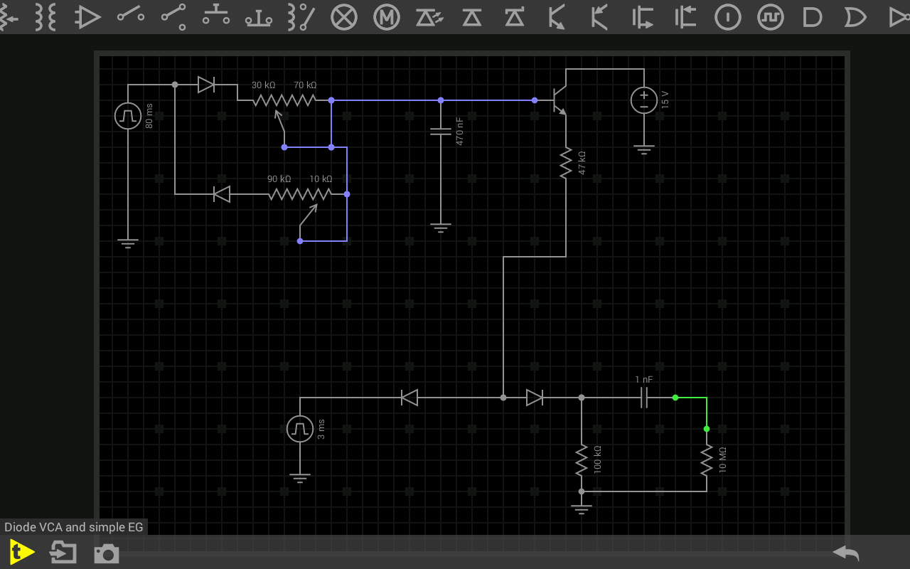

How can I change attack time? What will be if I will use sine or saw as input signal?

How ca7n I change attack time? What will be if I will use sine or saw as input signal?
It's easy to add an attack control ( see attached ) this type of VCA can only work with logic / rectangular signals.

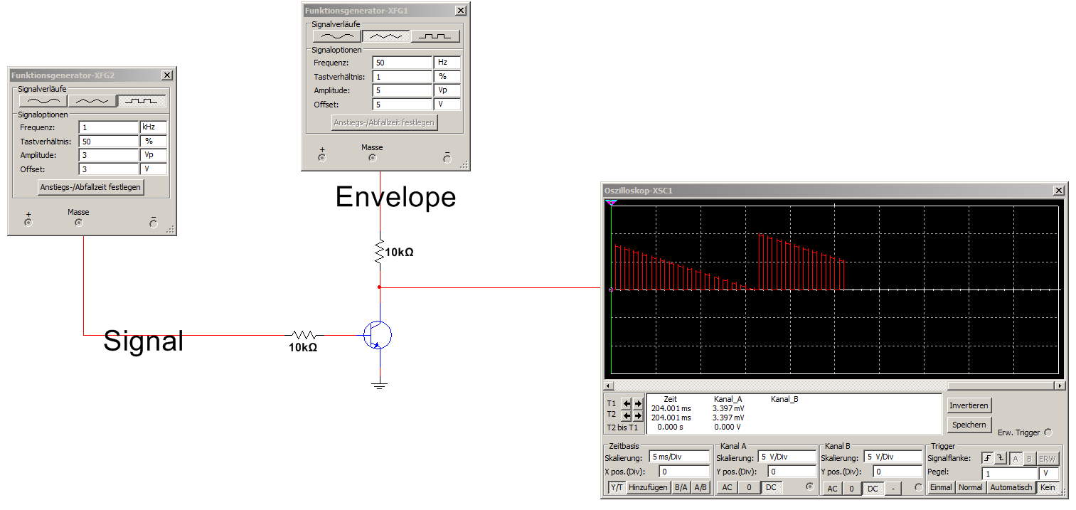

i was forced to remember something as i saw the simulation screenshot
 Filesize:  57.98 KB
 Viewed:  555 Time(s)
 Filesize:  63.03 KB
 Viewed:  536 Time(s)
