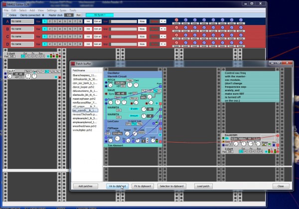

And a list of a few unconvinience factors of the editor that could be optimized.
1) knob move only horizontal.. best mode for laptops in the original editor is the circular mode.
2) you need to click twice to move a module. no direct dragging
3) you cant select multiple modules
brunov
Joined: Aug 03, 2011
Posts: 227
Location: delft
PostPosted: Mon Feb 11, 2013 12:32 am    Post subject: Reply with quote  Mark this post and the followings unread
Ok, you are using a laptop? Maybe that has something todo with the filter driver not working. But maybe we can look into that later on, for now I'm just happy that you want to help out Smile
- I'll put the rotary knob movement on my todo list
- Click twice to start dragging, I put that in on purpose, because I often dragged modules by mistake, whn I really wanted to connect a cable or turn a knob. But that can be made optional
- You should be able to select multiple modules by holding Ctrl down, or by dragging a rectangle over the Module names (left-top corner).
About the patch load calculation, I think I made some progress, by studying the manual again and some experimenting:
Resource 3 (byte 5) represents Internal memory, max 128 bytes.
Resource 10 (byte 20..25) represents RAM, max +- 260000 bytes (256kWord)
This fits for most modules, but there is still a factor missing
So memory calculation should be:
Mem% = max ( (100*R3/128) , (100*R10/260000), (100*R?/?))
And the Cycles, I made a discovery by uprating a module, so a module that has normaly blue output, turns to red output when modulated with a red source, as shown in the picture.
So I think Resource 1 (byte 1,2) and resource 6 (byte 12,13) represent Red Cycles and Resource 2 (byte 3,4) and resource 9 (byte 18,19) represent Blue Cycles.
Don't know why they are put in twice, and don't know exactly what the max values should be. Resource 5 also plays a part in the cyles. So for know I have this formula which comes close:
Cycles% = max( (100*R1/1352 + 100*R2/5000), (100*R5/258) )
So far the patchload.
Last thing I did yesterday was put a new version of the editor on the SourceForge site: v0.26. It contains a new category "Test" which has the blue2red red2blue modules.
Also solved some issues with setting the master clock.

If Im the only one to want this function, forget that!
Maybe not exactly what you asked for, but something that I might be able to do relatively easy is a "patch buffer" function. I made a mock up as to illustrate this.
So with the knob "Add patches" you can load a selection of patches from disk.
Knob "VA to clipboard" you can select the VA part of a buffered patch and put in on the clipboard. So the you can past this in one of the active patches in the 4 slots.
Knob "FX to cliboard" does the same for the FX patch part.
Then you could als make a specific selection of a patch from the buffer, put in the clipboard and paste in in an active patch.
Or you could just load the whole patch in a selected slot with button "Load patch".
This could also be usefull if you build your patches from building blocks.
 Filesize:  260.92 KB
 Viewed:  351 Time(s)
Yes! This is exactly what Im doing since I got my G2 last week. Can you save the setting from each module with your "patch buffer" ?
