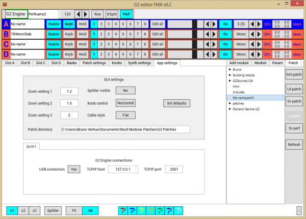

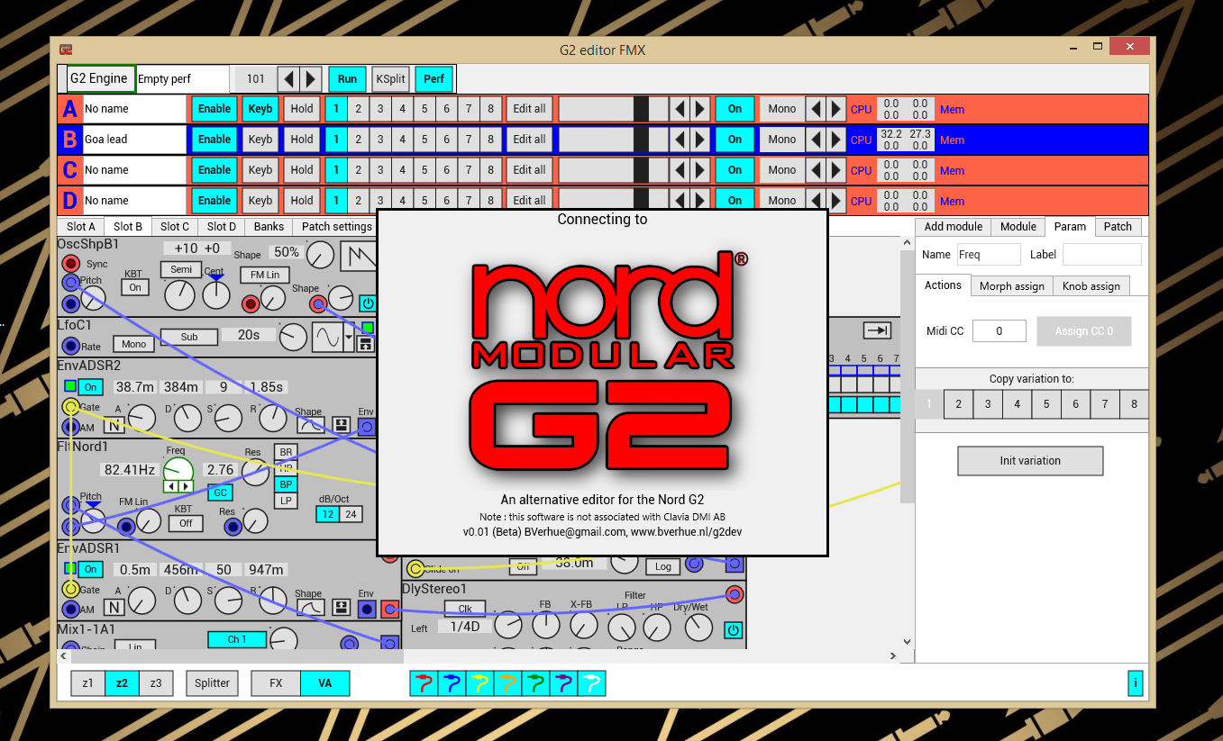

PostPosted: Sat Jan 04, 2014 2:16 pm    Post subject: Reply with quote  Mark this post and the followings unread
I think I reached a stage where my new project is ready for some beta testing. Smile Phew, has been quite a lot of work, but it seems to work o.k. now both on Windows and OSX.
So this is an G2 editor with an experimental user interface. I'm really not sure if it will be an improvement over the old interface, but we'll see, it's a start.
I've tested it on a couple different computers and operating systems:
- Windows XP : works, but graphics are not great
- Windows 7 : works, graphics a bit better not as good as Windows 8
- Windows 8/81 : works, graphics are good
- OSX Snow leopard : works, graphcs are good
- Android : haven't been able to get usb working, graphics not great
- iOS : tested once on the emulator, no usb, slow and graphics where not great at all.
I meant to make somthing that can be used on a touch screen, but I have not been able to try it out except on a low-end Android device with a very small screen and without an USB connection. On that device it didn't work very well.
So, not much succes yet on tablets, but I'm happy with the results on OSX and Windows 8 for now. The most promissing tablet at the moment would be one with Windows 8 installed. I don't have such a tablet, maybe someone else can try this out.
I created a help file, this is located here : http://www.bverhue.nl/G2editorFMXHelp/G2_editor_fmx_help.html.
I also created a page where the editor can be downloaded, you can find it here : http://www.bverhue.nl/g2dev/?page_id=17
You must realize this is all very experimental software, it will not work without errors in this stage.
On windows, it is necessary to install Libusb, I think this is not necessary on Osx. Either way, If you want to try it out, read the helpfile first and post a reply here if you don't understand something.

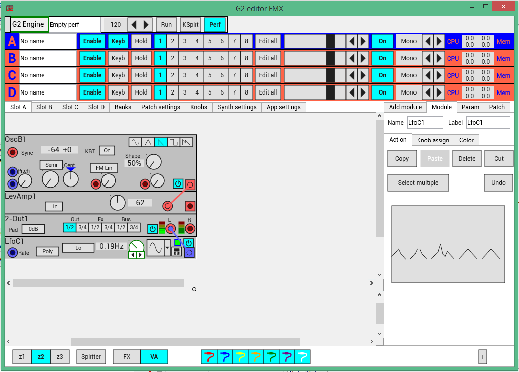

PostPosted: Sat Jan 04, 2014 4:02 pm    Post subject: Reply with quote  Mark this post and the followings unread
That looks good Bruno.
Just read the help file, and I think you are presenting some interesting ideas for the user interface, and it looks to me that a good lot of those would work on a touch device.
Heh, cable drawing will take some getting used to Wink
Is there a way to get a version deployed on an iPad? I do have an iPad with iOS6 (could upgrade to iOS7) and a Win8.1 PC with Delphi XE5 here, but no phone support for XE5.
Posts: 24551
Audio files: 301
PostPosted: Sat Jan 04, 2014 4:10 pm    Post subject: Reply with quote  Mark this post and the followings unread
The zero Hz option for oscillator frequencies seems to be not present in the editor (in Partial mode), the 2nd step does display 0.004 Hz correctly tho, so I assume this to be cosmetic only. (have no actual G2 attached).
I would like to have a better visual clue as to what module is selected - like the title background going into a different color .. also the module alignment seems off by one pixel .. when you now select a module in the middle of a bunch of modules it is almost like it visually goes to the background.
The imaging scales really nice - win8 here.
For a touch screen the tabs seem a little small to hit - but can not test that .. heh .. now i wish i would have bought this new win8 thingie with a touch screen Rolling Eyes
The init variation ... not sire how you implemented that .. on the clavia editor you can copy a variation to the init variation, then go to a variation, then hit the init button to initialise that variation with the init variation ... that seems not possible in your editor?
And .. in the Clavia editor there is an option to select a bunch of modules, then hit ctrl+c to get 'm on the clipboard, then go to another variation and then hit ctrl+e to copy the knob settings over to that other variation - very handy!
Also the keyboard shortcuts 1 .. 8 to select a variation are much used here. You can actually play a patch by changing variations that way, its fun Smile And also handy to quickly copy over settings from one variation to another.

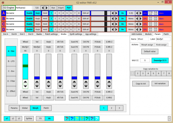

PostPosted: Sun Jan 12, 2014 3:07 am    Post subject: Reply with quote  Mark this post and the followings unread
Ok Jan, your comments where very usefull. I think I managed to solve most problems.
I've made a new Beta version 0.2 which can be downloaded on my developement page: http://www.bverhue.nl/g2dev/?page_id=17
The list of problems solved in v0.2:
1. Osc didn’t show zero Herz correctly in partial mode
2. Changed border for selected modules to dark gray in stead of white, to make them stand out better
3. Spaced modules out a few pixels in the patch window also to make the selected ones stand out better
4. “Init variation” function wasn’t implemented correctly, also added a button “Copy to init” on the Param tab.
5. Added “Select all VA” en “Select all FX” on Module tab.
6. Implemented the “Paste params” function (Ctrl+E), also added a “Paste params” button on the Module tab.
7. Implemeted function “Change morph labels”: select Morph in Knobs frame, select a slider, on the Params tab you can edit the label.
8. Added a knob Default value on Params tab.

10. Icons of the level shift controls on LFO’s didn’t match the selected value, corrected that.
11. Sustain pedal morph button has three modes “Sust pd”, “G Wh 1″ and “knob”, I had only put in two, corrected that.
12. Corrected an error in the Delete buttons of the Add Cable popup frame.
13. A number of small bugs.
One thing you mention about assiging CC to Morph should already be possible, at least when I try it works: select a morph slider, selct Param tab enter CC number in Midi CC edit box and press Enter, then click on button Assign CC. See image below.
The other thing about holding down a knob and changing the variation to copy the value to that varition. Did'n manage to include that in this version. Have to think about that one.
I'll update the help later on.

This is such an awesome piece of work, and now I've finally gotten around to trying this some more. I thought I'd try it out on my OSX machine. I haven't read through the manual yet, but I ran into a problem.
Testing on a G2 Engine, OSX 10.9.1, my iMac is 3-4 years old, with 3.2 GHz Intel Core i3, 4 GB 1333 MHz DDR3.
I opened up the fmx editor. It connected to my g2 just fine and I got a nice view of what is running on my machine. I moved some modules around a bit, it's a bit slow in updating but it works.
I wanted to try to make a sequencer patch, so I removed everything (first stumbleblock here was that I tried to first find a "new performance/patch" action to no avail, then I tried to select everything by dragging the mouse like on the old editor, but that seems to move the canvas around - I got it working by ctrl-A and then delete - possibly I just need to read the manual a bit more).
Then I added modules by double clicking them in there, making connections by single clicking (again, I probably just need to read the manual to get this to work more fluently). Then I made the last connection to the audio out and expected some sound, but there was none. I figured I had made something wrong with the sequencer thingie, so I removed connections and just connected the oscillator straight to the output, still nothing.
I felt that something was wrong here, so I closed FMX and opened Clavia's editor, which immediately showed me a dialog saying "Version Corrupted. Ctrl assignment problem." Can this be related to why there is no sound? The patch is still in there somehow and shows up when I open Clavia's editor (though it complains as above). When I open FMX now it shows "No synth". I'm going to try rebooting and reproducing.

Hm couldn't reproduce easily... I'll keep my eyes open for if it happens again.

Jan, about loading a patch. There is a "Patch directory" edit box on the "App settings" frame. If you put in your root patch directory, you can push the "Refresh" button on the Patch tab to update the file treeview. There are also the load/save patch files or performances buttons. See picture below.
Just to make sure, I'd save patches is a special test directory because the risk of patch corruption, what Antimon might have run into. If you run into a corrupt patch please send it to me. I haven't run into corrupt patches myself.
Just set it to c:\ ... don't try that at home Laughing (it crashes the editor). Oh and it will not start again after that either ... tried to edit appsettings.xml but that didnt help either ...
Special directory, yup, good plan.
