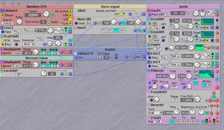

Hi all,
Just wondered if we could start a thread on how to make interesting and controlled random patterns/sounds. Following a brief quiz with Jan on the subject yesterday, he advised me to post something up on here n see how u all do it.
I have managed to get my head round quite a lot of the sound synthesis aspects of the Nord but I am struggling with the evolving concepts (such as complex arrangements of logic n sequencers), i find i am having to do the leg work with controllers, rather than getting the nord to do the labour.
A couple of pics below: 1st one is a really basic couple of controlled random modules, the lfo one, is quite cool cos u can get it to make repeatable random seqs rather than usinhg the random pattern module.
second one: the nearest i have got to a self controlled machine.

Ross, could you post the patches as well ? Would save me some time in copying
To me the sequencer approach usually does not work out very well, as it keeps on looping around forever doing the same. It doesn't even matter very much how long the sequences are, after a few loops it will be obvious anyway.
What I sometimes do to get some life in itis to set some of the loop lengths to odd numbers like 11 or 13. Usually the sequencer reset is tied to the clock's sync output and you can play a bit with when things get synced.
Alternatively some post processing could be used, either on the looped control signals or on the audio signals resulting from it.
On the other hand, plain random doesn't do the trick either, there has to be some order to make it attractive.
It's a bit hard to be specific about this as basically I just try stuff till I'm pleased by the results. To illustrate I'll add an example patch that I made based on this thread. I picked this one because it's a relativly simple patch.
This a a bit of a funny way of turning things around, the basic sequence is a random one, but when it would play the same note an alternative selection is used. The funny thing is that altough I would have expected the output to be more random instead a new order seems to be imposed by the switching process itself. A sort of a lucky find.

Thanks Ross, but the point is: get rid of those sequencers, they are boring and they are not needed ... well it depends on what music you want to make of course, but they are over-used and over-rated IMHO
The patch above uses a bunch of LFO's with feedback. In this case, to get something of a steady pace, in it I used sample & holds to sync the outputs to a clock, The amount of feedback used, together with the speed of the LFO's determines an amount of randomness vs staticness. Putting slow random LFO's on that to modulate it gives some variation over time. When you want it to be more messy leave out the synching.
Here is a tribal-like variation, same idea as above. anyway, you can make it as nuts as you like, or tame it instead.
