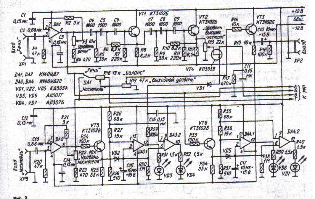

PostPosted: Mon Sep 15, 2008 10:56 pm    Post subject: I am going to assemle! Reply with quote  Mark this post and the followings unread
Hi!
I have a schematics diagramm of vocoder from 1980. The source Sovyet (USSR) magazine.

PostPosted: Thu Sep 18, 2008 12:17 am    Post subject: USSR vocoder Reply with quote  Mark this post and the followings unread
Hi!
It includes analog of CA3045 for VCA's
how to share scans here? Just to attache?
Thanks for interest!
http://ziart.kz

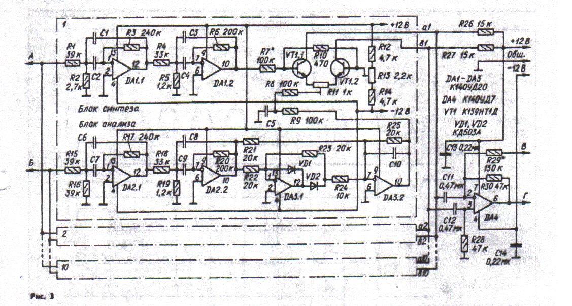

PostPosted: Thu Sep 18, 2008 12:36 am    Post subject: SOviet's vocoder Reply with quote  Mark this post and the followings unread
It qwite simple, very close to Okita vocoder, it includes VCA's on K159NT1D - 2 matched transistors
nothing special at all

PostPosted: Thu Sep 18, 2008 1:49 am    Post subject: About components Reply with quote  Mark this post and the followings unread
Hi!
K140 UD 7 is full analog 741 U could excnage for any tipe like TL072,TL 074
k140 Ud 20 - simple double 741 - TL 072 completely fits!
If you examinate this schematic U find that it is clone of Okita vocoder without NE570
and little bit simple
http://ziart.kz
