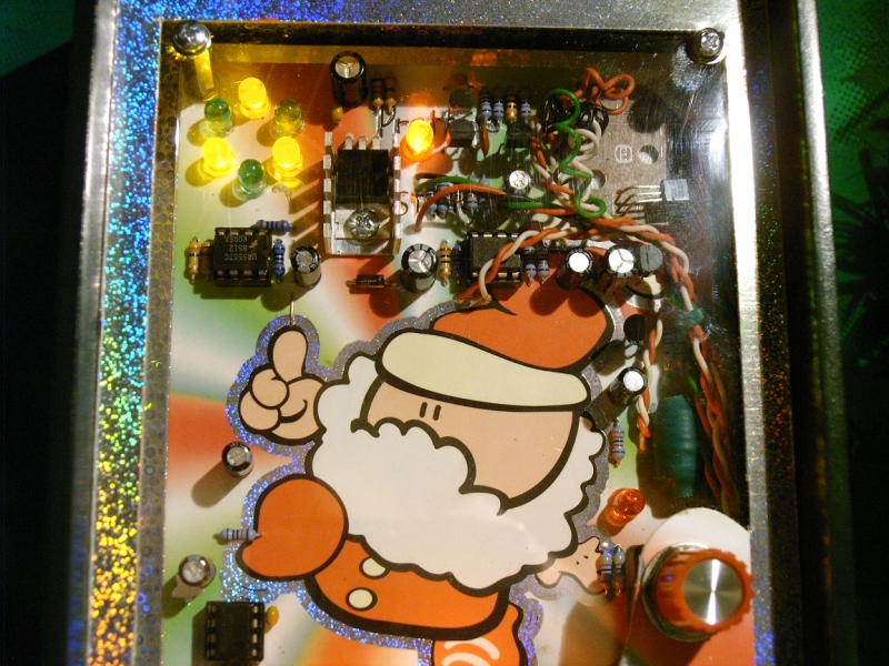

Posted: Tue Dec 27, 2011 12:36 am Post subject:
haha! what a nice build. look like the ultimate christmas pinball machine to mee... _________________
