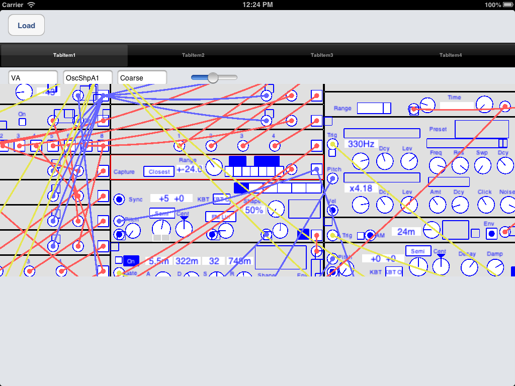

Ok, got a big part of the code to run in the iPad simulator. Smile
I can load a patch, display it and do a bit of zooming. Seems network is available also but haven't tested it yet.
The graphics are quite ugly, I hope this has something to do with the simulator. The fonts don't seem to scale properly. And it is slow! as expected.
But it's a start...

Great work! It looks "early Ableton".

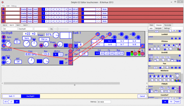

So because there is a "proof of concept", I would like to think about the user interface of a g2-touch-screen editor first, wether it's a iOS/Android or Windows surface application can be decided later on.
I've made a concept application, to try some things out. It's not finished of course, you can see it in the screenshot.
The goal is to be able to make patches on a relatively small screen with your fingers.
So on top I would like to leave the four slotstrips with the slot functions that are used the most, like patch volume, variation selection and so on.
On the bottom left you can select a zoom setting. I think you need about 3. One zoom to get an overall view of the patch, one to zoom in on a module and one 1:1 view.
On the bottom right you can select the patch location. I think the horizontal bar which devides VA/FX in the original editor doesn't work on a small touch-screen so with these buttons you can set the main window on VA or FX or Patch settins.
Then on the right side you have a multi-functional panel. Can be used to load patches, add modules, set parameters and so on.
One important function in this panel is Module-Navigate. It will show a list of all the modules, sorted by column/row. So you can easily scroll through the list an when you tap a module the main window will focus on this module.
So that are some ideas I'm working on.

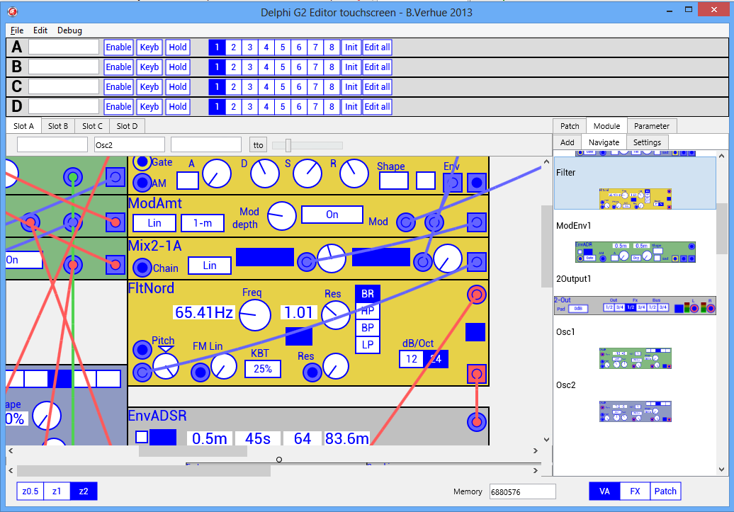

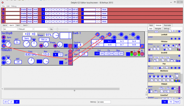

I've watched the video of the g1 and g2 edtors on the windows surface tablet. That made me think about some things. It would definitely be an improvement if you can zoom in on the patch, al the knobs should be made bigger.
Another thing that doesn't seem to work on a touch screen is dragging cables.
What I think that I'll do to try and make an interface in which as much tasks as possible can be done by max two finger points on the screen.
In the first finger pointing action you select an object, and depending on the object the inerface goes into a certain mode.
For example you point to a connector and the interface goes into cable drawing mode.
The scond finger pointing action results in a change depending on the current operating mode.
So if it's into cable drawing mode and you point to another connector, a cable is created.
You see an example in the screen shots. In "G2Touchscreen2" I've made some patch and I point to connector BP on Fltmulti1.
The result you see on screenshot "G2Touchscreen3", a small yellow rectangle opens up, indicating that you are in cable drawing mode.
The rectangle has three buttons, on the left you see "sv8-11", "OscshpB1". These are the existing cables on connector BP. If my second point is on one of these buttons, the corresponding cable is deleted.
Or if my second point is on button "Cancel", that would cancel cable drawing mode.
Or my second point is on any other connector in the patch, that would create a cable from the first pointed at connector to the second.

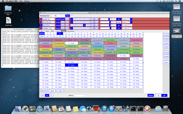

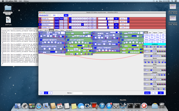

I got the new editor working on the hakintosch though, without too much effort! Personally I think the Delphi people did a good job, making a multi platform compiler. They go a lot of critisim but and it took a couple of versions, but now it seems to work. I'm using libsub-1.0.8 on Mountain lion.
Here are some screenshots, the only thing is that the applications don't look the same on different platforms. Because I mainly develop on Windows, that version look a bit better now.
The second screenshot is the "patch manager" I'm working on.
I think I will set up an internet page so everyone who is interested can test the application and maybe participate with making some of the graphics.

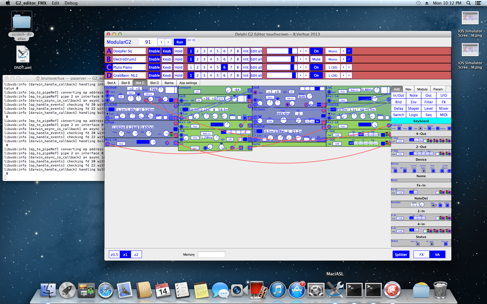

I'm looking at these screen shots and thinking, if this was a standalone app with full audio (like the G2 demo), rather than an editor, it would be the best app ever to be released on the iPad.

Hi, Brunov! Impressed of your work! Using it with two instances of G2m on pc and it is really great! Waiting for android devices release!

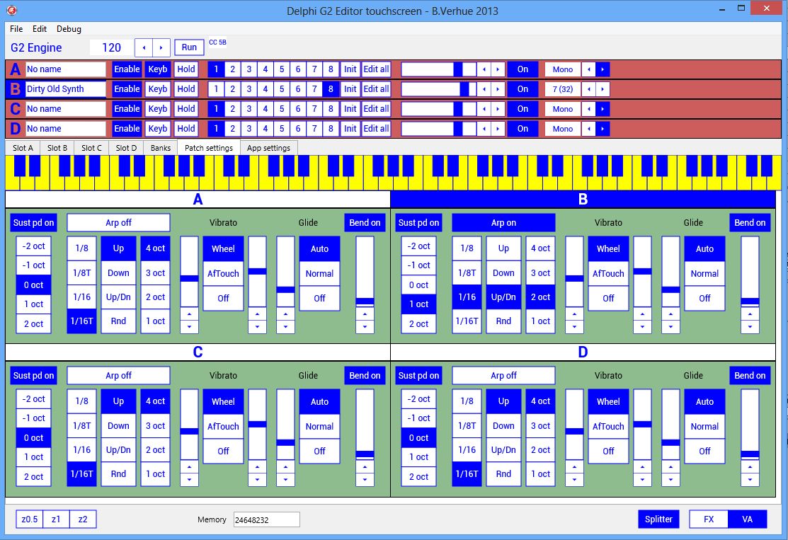

this is really impressive! Amazing you made this in such a short time. I'm listening to your noodle recording right now.
I'm close to releasing a first beta of the new g2 editor. Maybe the gui part of the editor might be useful for your project also.
