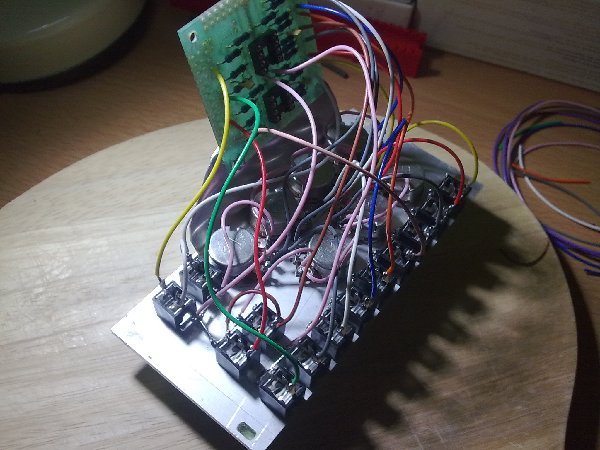

i built a new module combining a simple divider and attenuverters. this is what i use my existing attenuverter and a divider for frequently: nice sequencing.
this module is bipolar and it is working quite nice. i still have to straighten out some minor issues...
nevertheless, sometimes it is good to build something just to recognize that you don't need/want it!? i mean, why bipolar? since i use it for sequencing, and since i use quantizers i would do fine with a unipoar module. so i will redesign/simplify the whole thing, i believe...

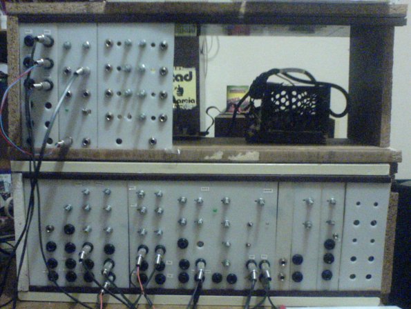

Hi all ..
I know it's not really good looking (comparing) ,but i was in a rush to play it .. it's not much it's just the doepfer diy synth with 2 more lfo's added .. and a dual which needs to be wired .. two sample and holds splitters ,clock ,noise gen .. and the bugbrand dual pattern gen which i'm wiring right now ... thanks to everybody in the forum they've been understanding for my dumb questions
greetings
vlad

each of the 4 dividers outputs are sent to an attenuverter. this voltage is then sent to a single out, and to the sum. so at the SUM out you get stepped voltages (see screenshot below). it works at audio rates too.
for the next module i will just have attenuators, and the divisions will go to the single outs w/o attenuation.

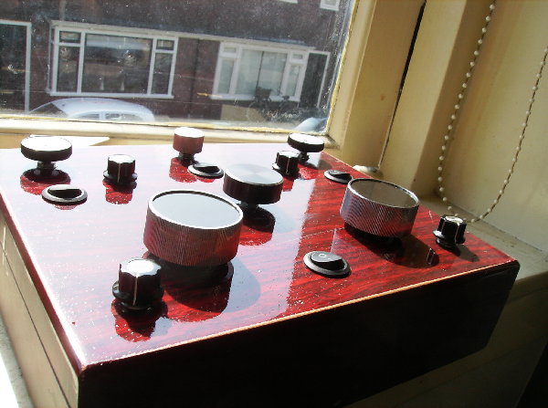

It has been a while since I posted here but I finally have something to show.
youtube description:
This project has been a long time coming, but the first prototype is finally done. Still some minor changes to be made, mainly around the filter and a CV input for the filter. Im currently developing a kit, contact me if you're interested.
-2 triangle oscillators with fine tune knob for those tearing slow drones.
-2 triangle LFO's with interchangable capacitors to set the range.
-LFO amount for both sides
-LED reflector rate indicators
-custom filter with resonance control
-on/off and volume
sorry for the bad video quality, my camera is old and doesn't like low lighting conditions. The audio was recorded raw into ableton live directly from the output without any filtering or effects.
And here are the first 2 tracks made with the machine:
26-04-2011 sticky tape by Tropical Benny
Oregano 29-04-2011 by Tropical Benny

Excellent Tjookum! Very Happy
sounds great and makes me wonder how you did those LED indicators.
I always take apart all kinds of stuff and I found these little reflector bars under an LCD screen as backlight. They have little grooves on one side and they are sloped on the other so the light is spread sort of evenly.
That sounds like it could level a building
Laughing my neighbour agrees.

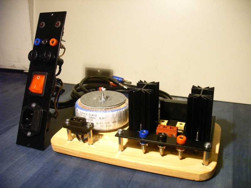

PostPosted: Sat Apr 30, 2011 1:05 pm    Post subject: Modular PSU
Subject description: +/- 15V 2x1A
Just finished the +/-15V 2x1A PSU for the modular. Smile
I've chosen for connectors instead of a direct connection between the panel
and the actual PSU, so it's easy to take it out. Because I don't have another
PSU for testing modules and it also makes it easier to replace it in case I
need to upgrade to a more powerfull one. I still have to make something to
distribute the power to the modules but haven't found the right connectors
yet.
What a beauty, I really like the attention to detail and the black perfboard. What schematic did you follow?
Thanks Smile
It's pretty much the basic LM317/LM337 schematic from the datasheet, which
is similar to the Ken Stone CGS66 +/- 15 Volt Power Supply but with some different
component values. (4700uF/35V Caps, 240/2K4+500R trimpot)
